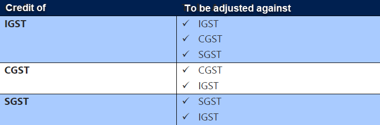

Hence, GST payable on sales transactions can be discharged by payment of cash or utilization of credit or both. Credit utilized can be credit pertaining to the same component or different components. As per Model GST Law, credit of IGST, CGST and SGST shall be claimed in the chronological order as given below:

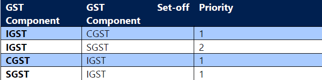

Claim Setoff Table: In order to permit users to define cross credit utilization, Claim Setoff table has been provided (GST Components – Actions). For each component of tax, the cross credit component and its priority can be assigned in this table. To illustrate, for discharging IGST liability, credits of CGST and SGST can be used. Similarly, CGST liability and SGST liability can be offset with IGST liability. This can be claimed in the Claim Setoff table as given below:
The first priority for any component would be that component itself. This logic is inbuilt. The above table is setting priorities for other components.

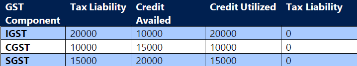

Examples for auto-population of Credit Utilized field in GST Settlement. Settlement entirely through Credit (System auto-populates credit utilized as given in the example)
Assuming the priority set out in Claim Set-off table given above, each component’s credit is utilized first for that component itself. Any balance left over can be utilized for discharging tax liability of other components.
In the given example, SGST Tax liability is Rs.15000 and Credit Available is Rs. 20000. The credit is utilized for discharging SGST liability first. Balance Credit of Rs. 5000 (20000-15000) is used for discharging IGST liability.
CGST Tax liability is Rs.10000 and Credit Available is Rs. 15000. The credit is utilized for discharging CGST liability first. Balance Credit of Rs. 5000 (15000-10000) is used for discharging IGST liability.
IGST Tax liability is Rs.20000 and Credit Available is Rs. 10000. The credit utilized becomes Rs. 20000, which is sum of IGST Credit – Rs. 10000, CGST balance Credit 5000 and SGST balance credit Rs. 5000.
