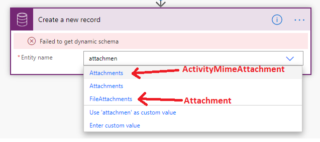

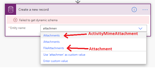

Problem: There are two Attachment entities in Dynamics 365 and CDS connector shows x2 "Attachments" in the entity selection list. When the entity name is chosen from the list of Entities in the CDS connector, the first one is ActivityMimeAttachment and the second one is Attachment. Those who are familiar with creating email attachments in Dynamics 365 using SDK know that it needs to be created using ActivityMimeAttachment entity. But the problem with creating ActivityMimeAttachment is that the lookup field to Attachment entity is mandatory and the system would not let to save the record without that value. Then, I attempted to create an Attachment entity and populate that lookup but the flow failed with the following error.
The 'Create' method does not support entities of type 'attachment'.
To resolve those issues, I had to come up with a workaround solution as mentioned in steps 5 and 6 using both CDS connector and CDS (current environment) connector.

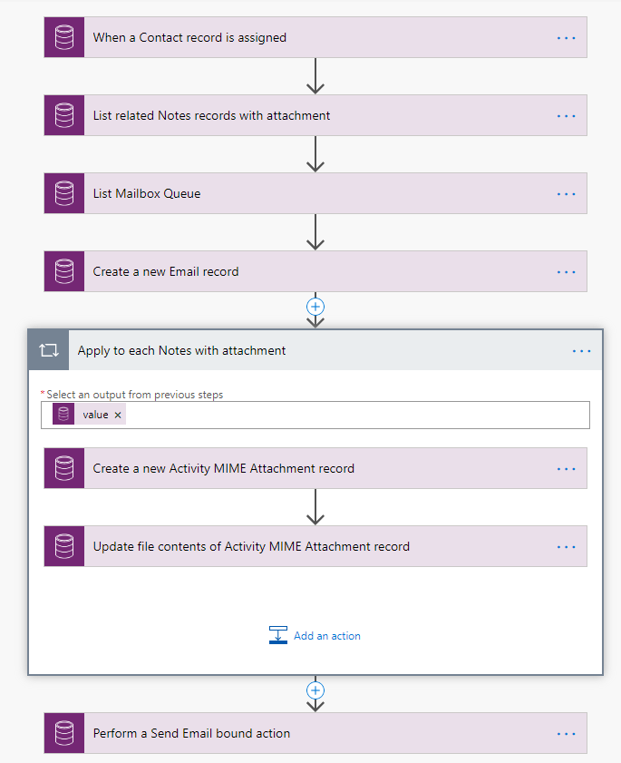

Sample Flow: The following sample flow is the simplified version of to above real-life scenario which is built with just out-of-the-box CDS entities (without Case entity). The sample flow triggers when the Contact record is assigned and it emails to the new owner of the record with the note attachments of the record.
This is the summary of the solution and the detailed explanation of the flow steps can be found below.

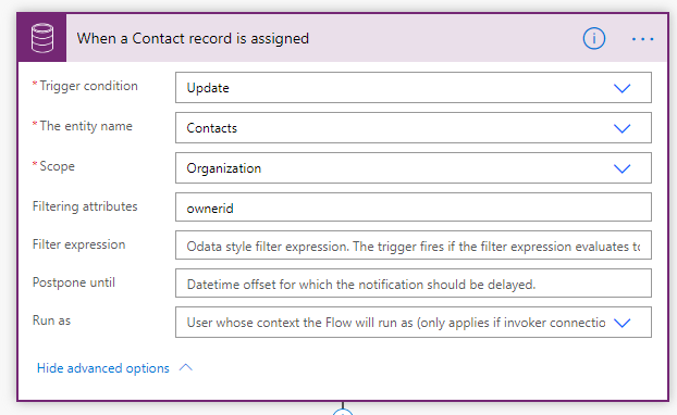

1. Trigger the flow
The flow triggers when the Contact record is assigned (the owner field is updated)

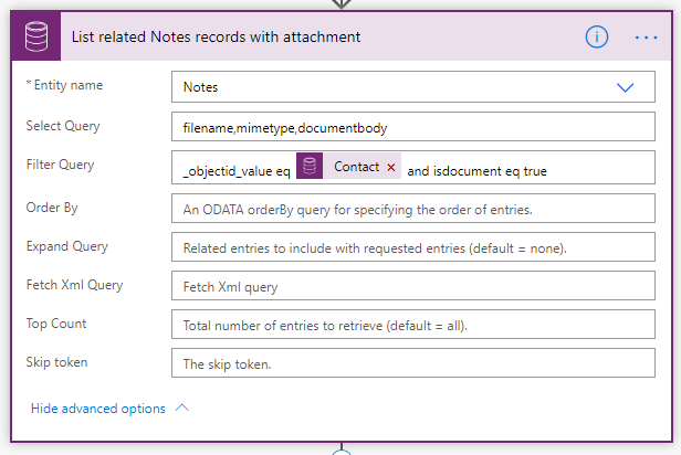

2. Retrieve Notes with attachment related to the entity
This step retrieves the Note records of the Contact entity with attachments (isdocument eq true)
Only 3 fields are required to be used in the later steps. (filename,mimetype,documentbody)

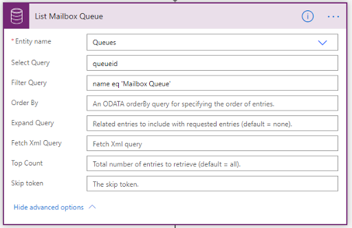

3. Get the sender mailbox queue
This step is just to retrieve the queue to set as the email sender From field. (the mailbox from which the email is to be sent out)

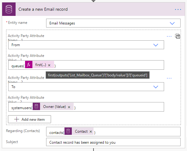

4. Create a draft Email record
In this step, a draft Email record is created to add attachments.
  • The Queue record from step 3 as a sender in From Activity Party. Assuming there is only one queue with that mailbox name is specified, the first() function is used to get the only record in the entity collection. (first(outputs('List_Mailbox_Queue')?['body/value'])?['queueid'])
  • The new owner User as a recipient in To Activity Party.
  • The triggering Contact record in the Regarding field.
  • And some value in Subject and Description (email body)

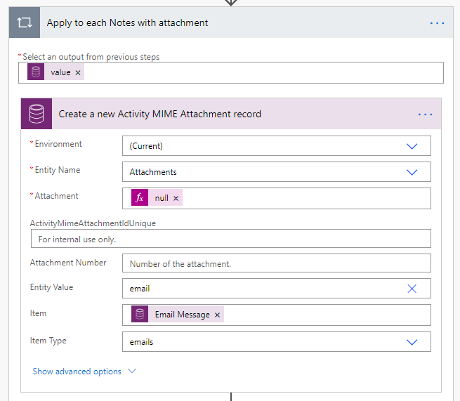

5. Create an empty Attachment record
Once the draft Email is created, the next step is to loop through the Note attachments from step 2 and create an Attachment (ActivityMimeAttachment) record.
As I mentioned in the problem statement at the beginning of the post, the Attachment field is mandatory for Attachment (ActivityMimeAttachment)  record. Since the CDS (current environment) connector cannot be used to set the null value to the lookup field, the Create action of Common Data Service connector needs to be used.
Select the first one out of x2 "Attachments" in the Entity Name list for Attachment (ActivityMimeAttachment) entity.
Set "null" value using Expression for Attachment field.
Enter custom value "email" (not integer Object Type Code) in Entity Value field, select "emails" in Item Type and the Email Message unique identifier from the Email record created in step 4.

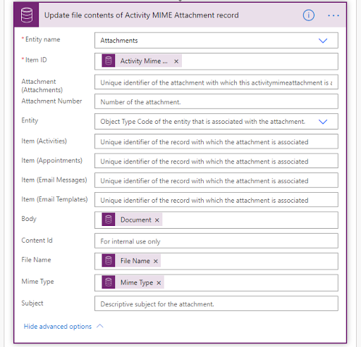

The problem with Attachment (ActivityMimeAttachment) entity Common Data Service connector is not being able to set the actual attachment file information (such as file name, content of the attachment, Mime type). That is why there is another step to update with the file information.

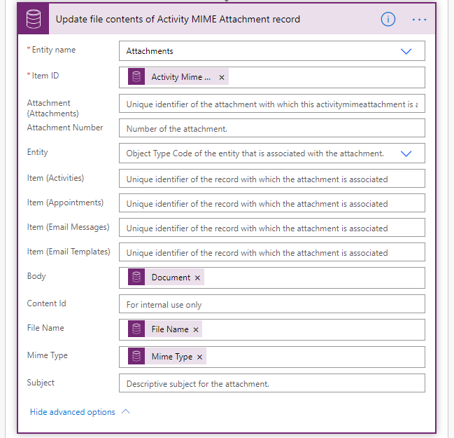

6. Update the Attachment record from the step above with file content from the Note attachment
This step is to set the actual attachment file information to the Attachment (ActivityMimeAttachment) record created in step 5.
For this Update step, Common Data Service (current environment) connector needs to be used.
With the Common Data Service (current environment) connector, Update action of Attachment (ActivityMimeAttachment) will show additional file information fields and populate Body, File Name and Mime Type fields need to be populated from the retrieved Note entity as in the screenshot above.

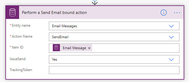

7. Send out the Email from the system
Once all of the attachments are created, the last step is to send out the draft Email using Perform a bound action step from Common Data Service (current environment) connector.
When the Email Messages is selected for Entity name, "SendEmail" Action will be available for Action Name.
Populate the Email Message unique identifier from the Email record created in step 4 into Item ID and IssueSend needs to be set as Yes. (then, the system will update the status of the Email record to "Pending Send" and the server-side synchronisation will pick up the email.
If the IssueSend is set as No, the email status will be updated to "Sent" and the email will be just created as a sent email. (but not actually delivered out of the mailbox)
