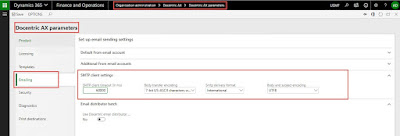

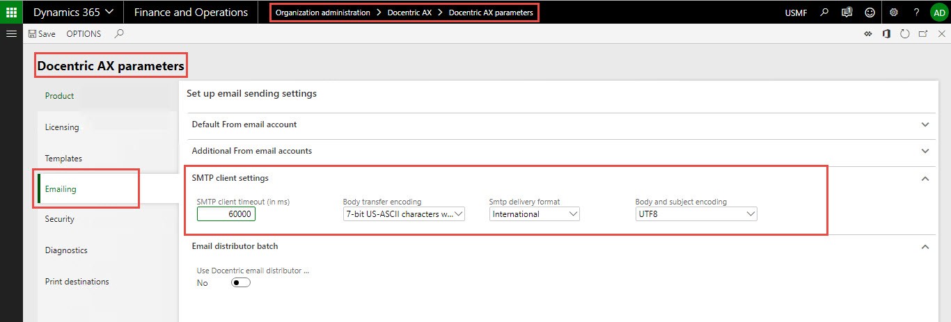

SMTP Client Settings:
In Docentric free-edition tool global parameters we can set up SMTP client settings. Beside standard SMTP settings such as Outgoing email server, SMTP port, if SSL is turned on, etc. you can set up also SMTP client timeout, Body and subject encoding, Delivery format, etc.
Navigation: Organization administration -> Docentric AX -> Docentric AX parameters

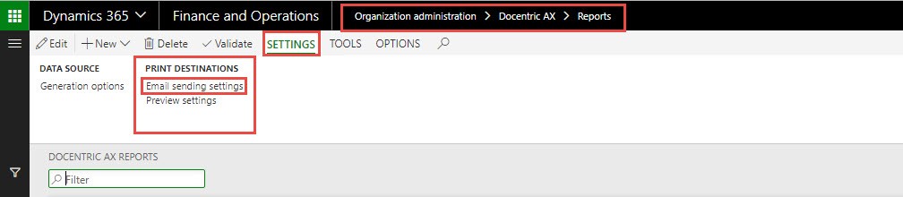

Docentric report setup provides multiple options. There we can choose Email sending mode (Synchronous or Email processing) per report. If we choose Synchronous, it will run as out of the box, by sending the email with a generated invoice and additional attachments synchronously. On the other hand, if we choose Email processing, the email will be saved to Email sending status, i.e. the outgoing email table from where it will be sent later by Email distributor batch.
Navigation: Organization administration -> Docentric AX -> Reports
By navigating this link, it will open Docentric AX Reports. Click the Settings tab and select Email sending settings as shown on the image below.
When you click the
Email sending settings menu item, it will open a form in which we can select Email processing as Email sending mode. Please see the image below.

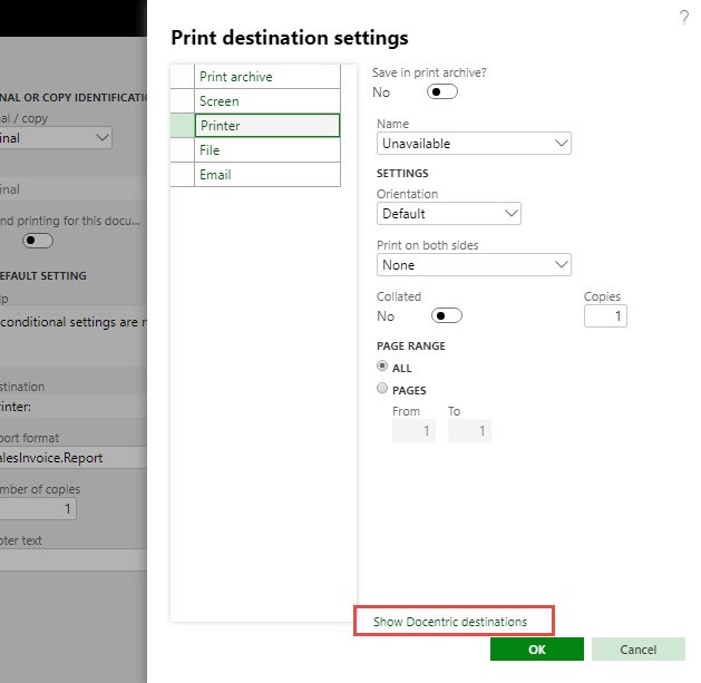

Select
Customer invoice and click the marked button to change the target print destination.
Provide To address, Subject and Body, and save your settings.

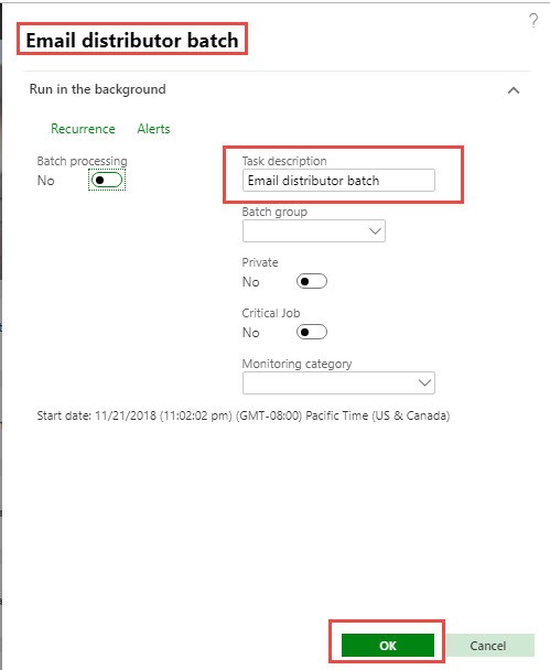

To send our email from Email sending status, we first have to make sure that we have SMTP server configured and running. Go to System administration -> Setup -> Email -> Email parameters and fill the required settings. Next step is to make sure that Email distributor batch is up and running. Go to System administration -> Inquiries -> Batch jobs and check if the batch job (E-mail distributor batch) exists with status Executing or Waiting. If it doesn’t, you can activate it from System administration -> Periodic -> Email processing -> Email distributor batch.

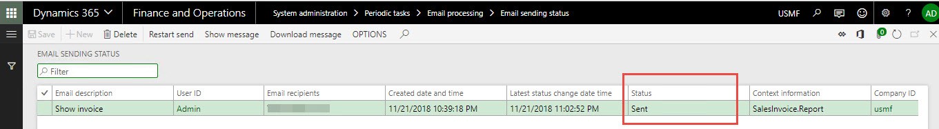

Now when we run Email distributor batch (as a batch job or without it) it will send all emails with the status Waiting, one by one (with retries and status controlling). The email status will change to Sent or Failed.
Now refresh the Email sending status form. You can see in the image below that our email is successfully sent.
That is how Docentric free-edition tool helps us to save emails with generated invoices, send them reliably and monitor the progress of sending.

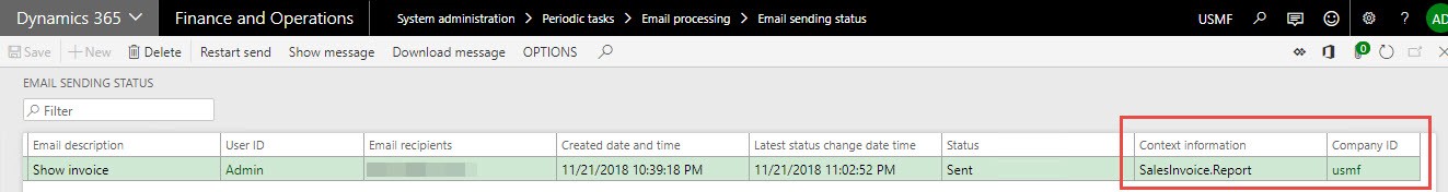

Email sending status enhancements:
Built-in Email sending status is also extended by Docentric free-edition tool.
  • Additional columns.
    • Context information (provides the information about the attached report)
    • Company Id (provides the information about the legal entity)

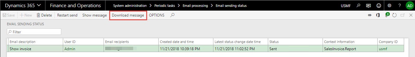

  • Download message as EML file that can be open with Outlook.

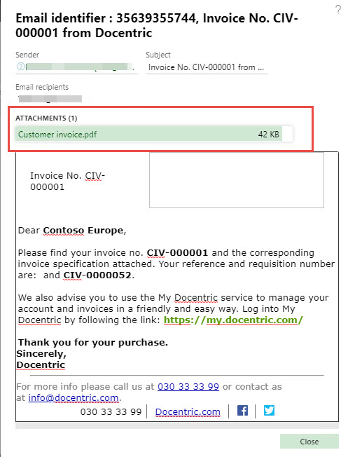

  • Show message is improved to show the list of email attachments as well. You can download one by simply clicking on it.
