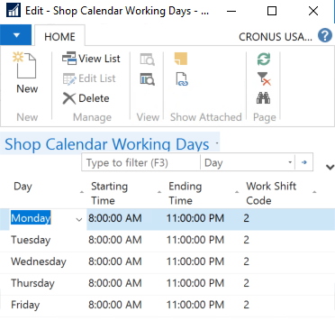

Once you have created the proper shop calendar master record you will need to enter the working days for each calendar.  Click on the “Working Day’s” icon in the ribbon.  NAV will display the following screen:
NAV Capacity Planning image 2
Enter the time range for each day.  This specifies when the shop will be working during that time.  The days listed here are for the shop calendar that you selected earlier.  They are specific to that calendar.   You will need to enter days for each calendar you plan to use.

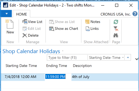

Holidays can be entered by selecting the “holiday Icon” from the ribbon on the shop calendar screen.   This allows you to tell NAV when the plant will not be working and for how long.

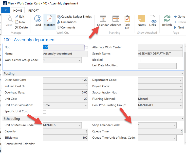

Work Centers will utilize the shop calendars for scheduling and capacity calculations.  To assign a shop calendar to work center, open the work center card and in the scheduling fast tab select the proper calendar.
NAV Capacity Planning image 4
After applying the proper shop calendar code, select the “Calculate work center Calendar” from the ribbon on the work center list.  Enter the date range you wish to create the calendar for and click ok.  This will create daily schedules for the work center.  The time unit scheduled will be based on the “unit of measure code” selected on the work center.  While it defaults to “minutes”, many companies find it is easier to work in “hours”.
You can view the Work Center calendar by clicking on the “Calendar” icon on the ribbon on the work center card.  The “absence” icon will show you when the work center will not be operational.  Clicking on the “matrix” icon will show the detail time for each day.
Machine centers are part of a work center.  Their calendars will be built from the work center calendar created in the previous step.  You can view a machine center calendar by clicking on the “calendar” icon in the Ribbon on the machine center card.   Clicking on the “matrix” icon will show the detail time for each day.

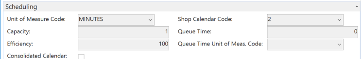

However, work centers and machine centers can be set with a finite load where the center may have limited resources and create a bottle neck.  In the machine center and work center cards there is a scheduling fast tab which allows for control of the constraint.
NAV Capacity Planning image 5
The capacity field represents the number of concurrent resources in the machine center.  A capacity of 1 is used for a constrained resource.   The efficiency field represents the percentage of time that actually will be producing output.  The queue time fields allow for time to move product from one work center to another and have it wait until capacity is open or time for finishing a process.  It is important to note that the fields listed above will not be used if the consolidated calendar field is checked
