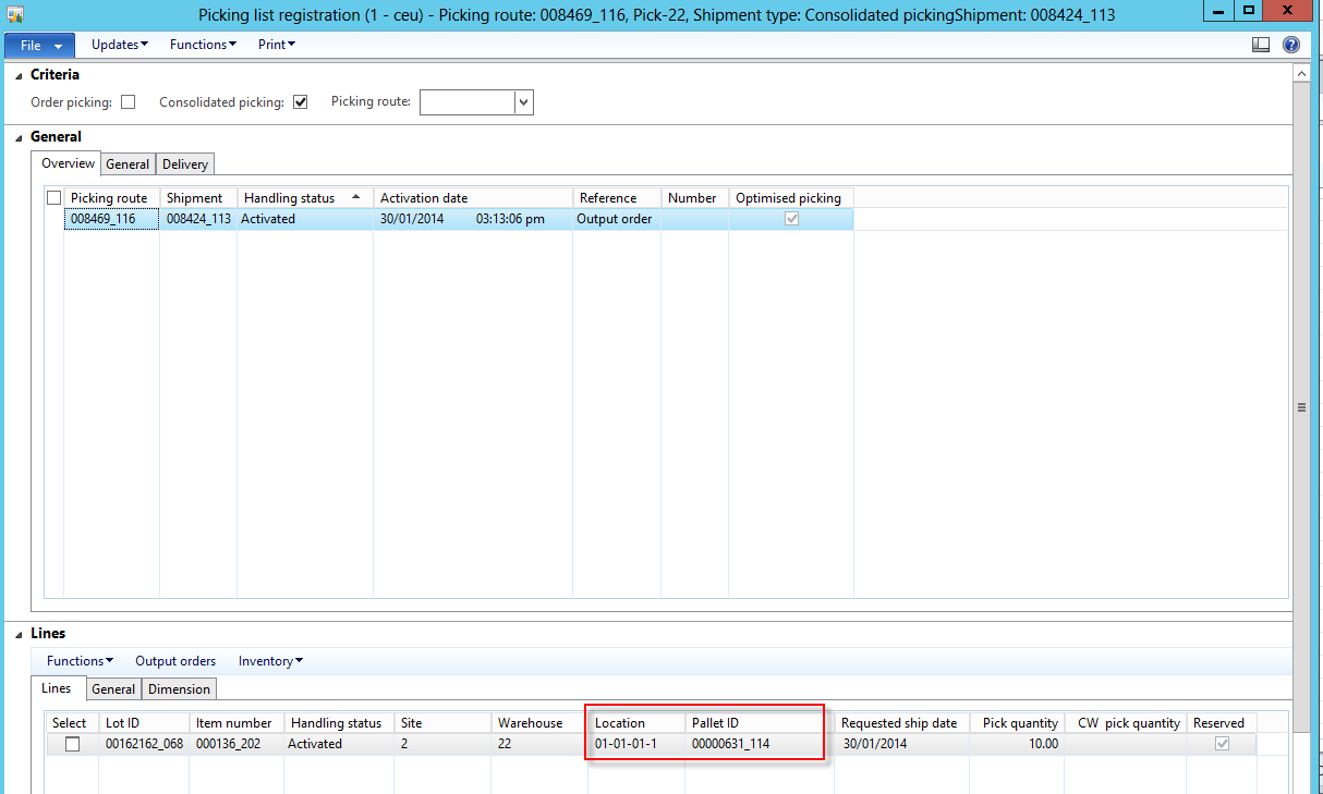

Look at the picking route, it shows that goods needs to be picked from the item picking location

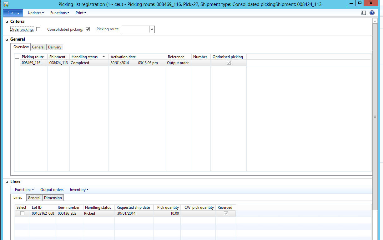

Notice that on hand is now available at the picking location, so we are good now the picking location has been refilled form the buffer location and now we can complete the picking list created for the shipment

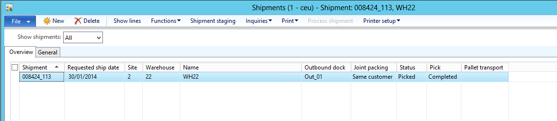

The shipment status changed to Picked
The inventory transaction is updated to picked from the item picking location
On the sales line the line quantity is shown as picked

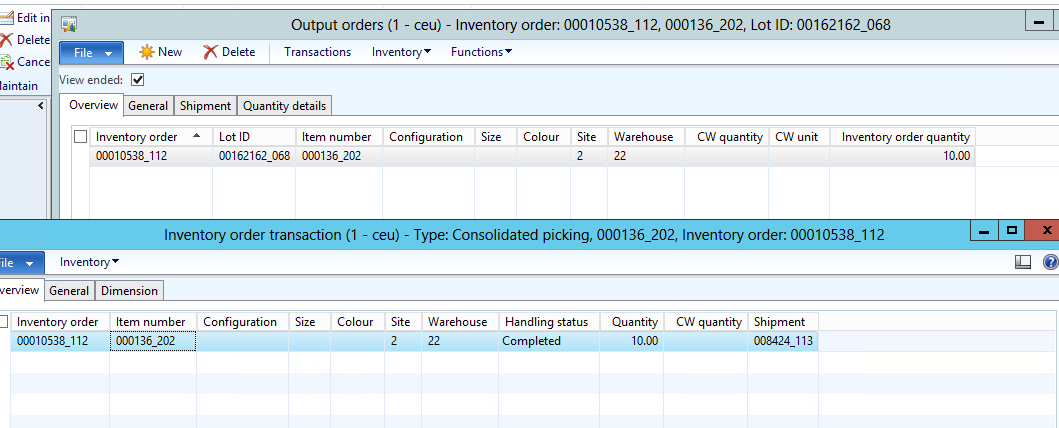

The output order is shown as picked
