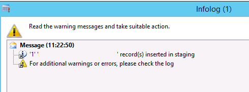

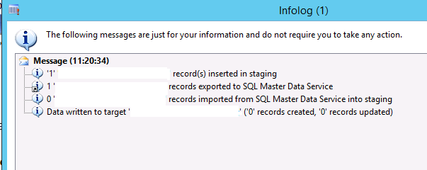

1. Only one record gets synchronized
Issue: When synchronizing a newly created entity for the first time, only one record gets synchronized.
Figure 6: Infolog message after one record synchronized
Solution: When solving this issue, first check how the data was moved to the staging table. You can start by reviewing the Processing group form, which can be executed by going to Data import export framework - Common - Processing group - Get staging data [button].
In doing this ourselves, this resulted with a different Infolog message, which specified some errors had occurred:

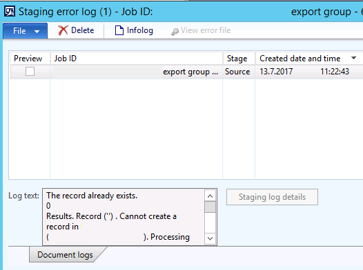

After opening the error log of the conflicting Processing group (select your Processing group, then press the Execution history button, and in the opened form select the newest execution, press Error log button), there appears to be an issue with duplicates in the staging table:
Figure 8: Staging error log form
The final discovery to resolve this issue is identifying the primary key that was missing from the staging table. By inputting the primary key you can eliminate creating duplicate records.

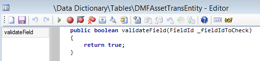

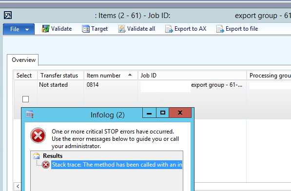

2. Stack trace error while validating staging data
Issue: Stack trace error received from trying to validate data for the Processing group Data import export framework - Common - Processing group à Execution history (button) - View staging data [button] - Validate all [button].
Figure 9: Infolog with stack trace error
Solution: Start by checking your entity’s staging table validateField method and make sure it has the following code:
public boolean validateField(FieldId _fieldIdToCheck, boolean validate = false)
if (!validate)
return true;
return super (_fieldIdToCheck);
A faulty validateField method error can occur when the code in your entity appears as such:
Figure 10: faulty validateField method
In this example, the system called this method using two parameters. However, the method only had one, hence “The method has been called with an invalid number of parameters” error was thrown. This faulty code was generated by the Custom entity wizard, which is used to create custom entities. Ensure you have the correct number of parameters defined to avoid this common error.

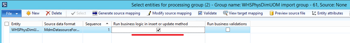

3. Inconsistent data
Issue: Newly created Master Data Management entity, for example new MDM entity for WHSPhysDimUOM table, doesn’t render value when the data was written to the target table correctly but when you open the product form, related values are empty.

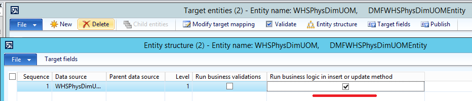

Solution: In this case, the related fields in InventTable are empty because they are being filled in by WHSPhysDimUOM.insert() method. This method was skipped by the Master Data Management import because by default it calls WHSPhysDimUOM.doInsert(), which skips the insert() method. To solve this, you need to mark Run business logic in insert or update method checkbox in two places:
- Entity structure form which can be opened from Target entities
Figure 11: entity structure form
- Select entities for Processing group form, which can be opened by selecting your entity’s import Processing group from Processing group
Figure 12: Processing group form
Now <target table>.insert() and <target table>.update() methods will be run when synchronizing Master Data Management entity.

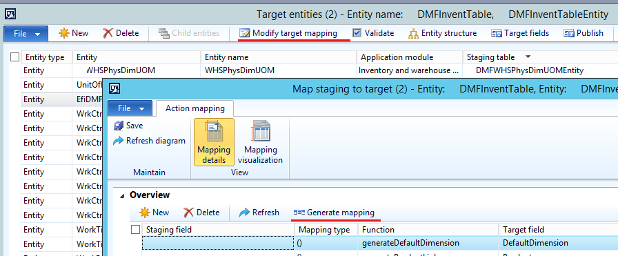

5. Data doesn’t go through correctly for newly added field
Issue: Data for a field is not updated when you create a new field by adding it to the staging table.
Solution: This most likely is caused by forgetting to refresh your entity. You can refresh using these simple steps:
- Regenerate mapping for your entity;
- Data import export framework - Setup - Target entities - Modify Target mapping [button] - Generate mapping [button];
Figure 14: Generate mapping button in staging to target mapping form

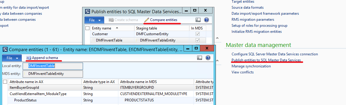

- Make sure the new field is added to Master Data Services;
- Data import export framework - Master data management - Publish entities to SQL Master Data Services - select your entity and push Compare entities [button] - Press Append schema [button] to add your field to Master Data Services.
Figure 15: Append schema button in "Compare entities" form

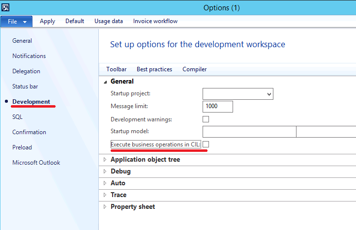

Troubleshooting Master Data Management with Debugging
If you still are not able to find a solution to your problem in this blog post, try debugging the solution step-by-step. First try debugging using the AX debugger and with Execute business operations in CIL checkbox deselected:
Figure 16: Execute business operations in CIL parameter in user options form
If the code that you’re trying to debug is run on a server level and the breakpoint is not hit, try debugging using visual studio (more how to info here).

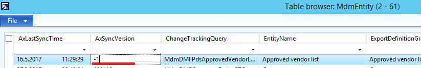

Tip: There may be instances when you want to force synchronization for all your entity records. In this case, there is one workaround that you can use – set AxSyncVersion field to -1 for your entity in MdmEntity table.
Figure 17: MDMEntity table with AxSyncVersion set to -1
