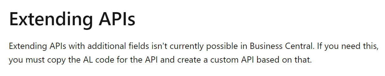

    So to this standard API is it possible to add any new fields or any customized fields. If not what is the option to do so. Means how to create a sales order in a single API ( Header and lines) with new custom fields \ new standard fields.
  • Suggested answer
    YUN ZHU Profile Picture
    101,113 Super User 2026 Season 1 on at
    Hi, Unfortunately, this is not possible as of now. This is mentioned in several Microsoft documents.
    More details:
    This page type can't be extended by creating a page extension object. Instead, you must create a new API by adding a page object.
    Thanks.
    ZHU
