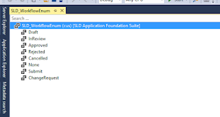

Step-1 Create custom Enum or you can use existing.
Reference screenshot.

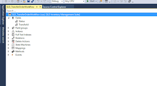

Step-2 Create custom table and add two fields Transfer order Id and Status field extend both fields with appropriate Enum or EDTs. In our case Table name is SLD_TransferOrderWorkflow

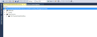

Step-4 Create Custom Query and Add the SLD_TransferOrderWorkflow table.

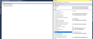

Step-5 Create workflow Type.

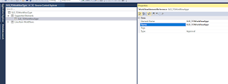

Step-6 Create workflow Approval.

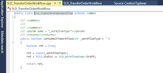

Step-8 Override the canSubmitToWorkflow  on SLD_TransferOrderWorkflow.

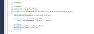

Step-9 Create method in the table to update status on workflow events/approval.

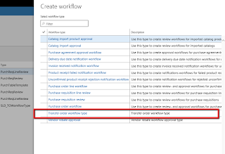

Step-12 Now navigate to workflow form of your module and click on new to create new workflow.
You can check in the below screen shot my workflow is appearing.
