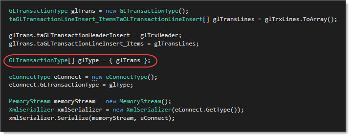

Here's an example of the serialization of a GL transaction.
Notice that this code involves a single GL transaction object, glTrans, with the glTrxHeader and glTransLines assigned to the object properties.
That single GL transaction is then assigned as a single element to the glType array, which is then converted to XML.
Wait a minute. Why is the GLTransactionType object, in this case named glType, an array?
Well, it's an array because eConnect Serialization supports the conversion of multiple transactions into a single XML document.

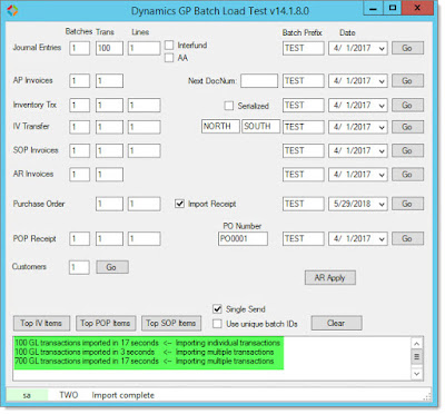

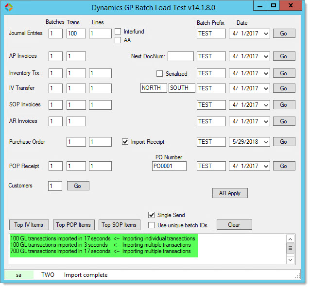

100 GL JE transactions imported in 17 seconds when sent individually to eConnect.
But when I submitted a single XML document with 100 journal entries, eConnect imported them in 3 seconds.
WHAT???
I then imported 700 transactions, submitting them all to eConnect in a single import request. They imported in 17 seconds, the same time it took to import just 100 transactions individually.
That's a 7 fold increase in performance, resulting from a minor change in the import code. That is a staggering difference.
WHAT???
