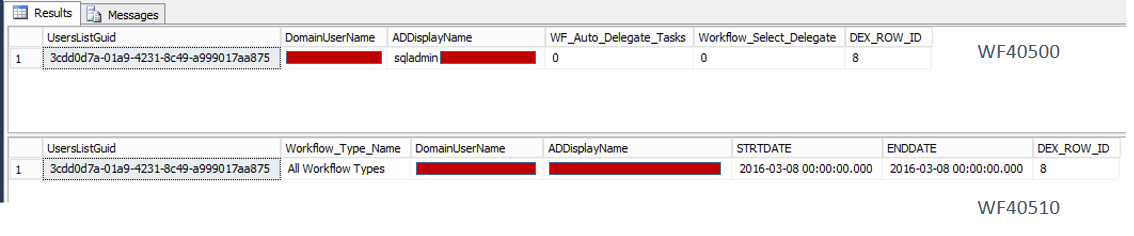

The delegations are recorded in WF40500 (Workflow User Delegation Master) and WF40510 (Workflow User Delegation Lines) as shown below:
Workflow Delegation Tables

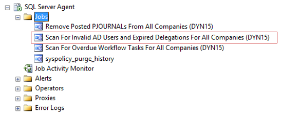

Workflow Delegation Company Cleanup
There is a job which purpose is "to remove out of office delegation records that are tied to invalid AD users.  It will also turn off Delegation for records that have expired."
Scan for Invalid Active Directory Users and Expired Delegations (all companies)
The job is scheduled to run on a daily bases once at 12:00 am, it primarily has one step which is running a stored procedure wfOutOfOfficeDelegationCleanupCompany in Dynamics DB. In Turn, this stored procedure checks for the available companies within Dynamics and clear all delegations regardless of the fact that they are active or inactive.
>> Therefore, any delegation that is submitted by any user will be deleted automatically at the end of every day, whether it is expired or not.
