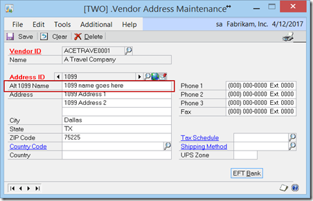

Next, we’re going to add a restriction to the report such that it only selects records from the PM Address MSTR if the Address Code is equal to ‘1099’, or whatever ID you choose. Just keep it consistent.
Now you need to decide which field on the Address window you want to use as the alternate 1099 name. I am going to use ‘Contact Name’. I used modifier to change the field prompt to read ‘Alt 1099 Name’. My modified window looks like this:

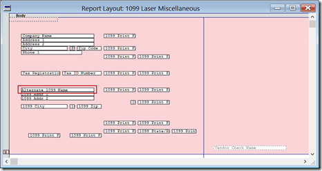

Now we need the conditional calculated field. I’m going to call it Alternate 1099 Name. We are testing for the value of the ‘revalue’ checkbox. If it is 1, we print the check name, if it is 0, we print the alternate name. The formula will look like this:
Finally, modify the report layout and replace the Vendor Check Name field with your Alternate Check Name calculated field. Keep in mind as you do this, that you may have to modify this report each year to keep up with the IRS form layout. My modified report looks like this:
1099 Report LayourI
I know it’s hard to see, but there’s a red box around the new calculated field.
