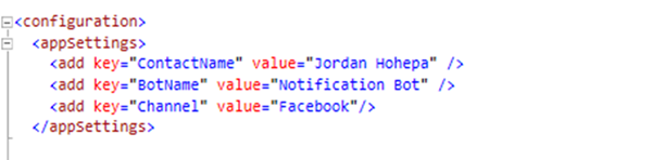

Recently I was tasked with developing a data migration for a large amount of data. I decided on developing a console application to handle this task. While developing this console application I ended up including logic which would connect to Dynamics 365 and retrieve my contact and bot information. The screenshot below shows the editable values I used to retrieve the Contact, Bot and Bot Connection. For simplicity, I kept it to these three settings.
