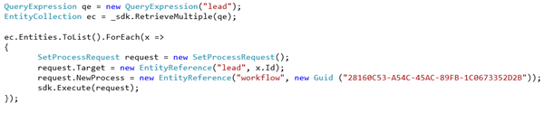

Through C#
Note: This logic will update the BPF for all leads.

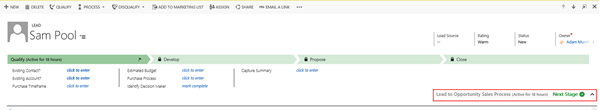

Before:
After:

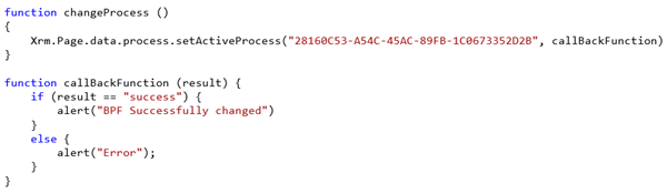

Through JavaScript

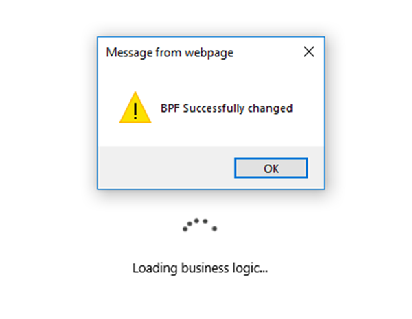

When I next opened the record, the below alert popped open and the BPF had been successfully updated! This is due to applying the above JavaScript on load of the form but you can apply this JavaScript other ways e.g. button click.
