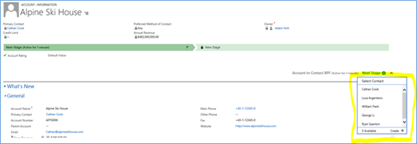

So, in what situations can you go from one entity to an existing record on another entity using a BPF? To do that a 1-to-many relationship has to exist, i.e. the entity in the stage before the entity change has to be the parent entity and the entity in the stage after the entity change has to be the child entity. So, if you have created a BPF which goes from, say, Account to Contact, when you are designing this BPF in CRM, you get the chance to select the existing 1-to-many relationship called ‘Company Name’ which exists out of the box:
Now, when I go into an account, and move it to the contact stage of the BPF, CRM asks me which existing contact I want to use, and shows me the contact s related to that account through the Company Name relationship.
I can still create a new contact if I want to, and move the BPF on to that new contact.
So, in summary, in order to go from one record to another existing record in a BPF, you can only go through a 1-to-many relationship. You can’t go through a many-to-many and you can’t go through a many-to-1.
