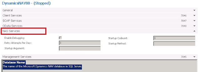

As you can see in above image, we have a Separate Tab for NAS configuration. Some parameters are known, but some are new. Let’s understand every Parameter.
Enable Debugging (If you want to debug NAS Session) - When this setting is enabled, the NAS services session waits 60 seconds before executing the first C/AL statement, to allow time for activating and attaching the NAV Debugger to the NAS services session.
Retry Attempts per Day - The NAS Services on a tenant is restarted after a failure up to the configured number of times in a 24 hour period. Once the limit is exceeded, it fails permanently.
Startup Argument – Yes we know it. The available options remain same as old days.
"ADCS, ADCSID=1" OR “OSYNCH" OR “JOBQUEUE"
Startup Code unit – Specifies the codeunit that contains the method that will be called by the NASStartupMethod setting.
0: NAS Services do not start.
1: Run the trigger specified by the NAS Startup Method in codeunit 1.
450: Run codeunit 450 (Job Queue - NAS Start Up), and call the method specified by NASStartupMethod.
Startup Method – Specifies the method that will be called in the NASStartupCodeunit.
"": If no start method is specified (null string), the OnRun trigger is called.
StartNAS: NAS services runs the StartNAS method in the NAS Startup Codeunit.

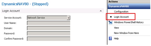

** Make sure that the new service which you configured is running with a domain account having sufficient permission on SQL and Navision. Change here as below, do not keep it Network service.

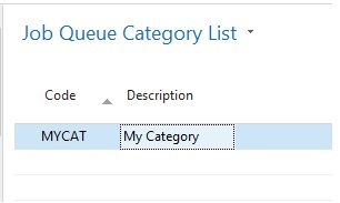

First Thing we need to setup is Job Queue Category List. With the Category the Job Queue and Job Queue Entries are grouped. So Just add Code and Description as per your need.

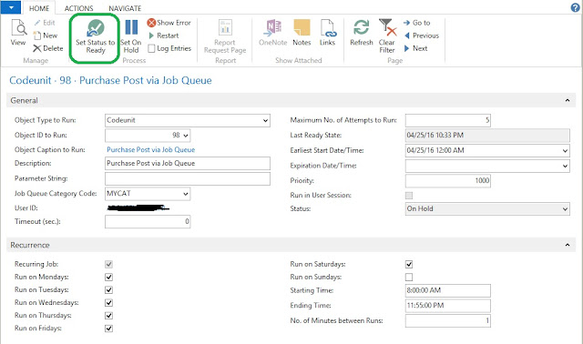

Next is to create Job Queue Entries, which are same as of old days.
You can setup the parameters as you used to.
- Select the Report or Codeunit that you want to schedule.
- Select Parameter if required.
- Select Job Queue Category Code Created above.
- Other parameters are self explanatory.
- In The Next Tab (Recurrence) you can setup when you want to run the batch and also the start and end time when it should run on the selected day.
- And between the Starting and Ending Time, how frequently you want to run (in minutes).

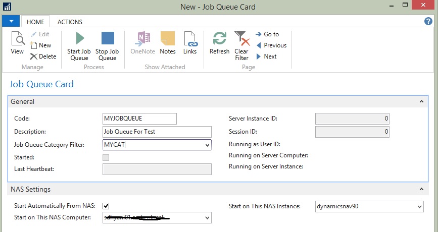

Next is to Create a Job Queues as shown below.
With NAV 2013 onwards, if you want to setup to run automatically then setup the NAS Settings Tab.
If you are testing then Don’t configure the fields in the NAS Settings and for testing use Start Job Queue and Stop Job Queue from actions.
Once you setup you should see something like, which means Job Queue running.

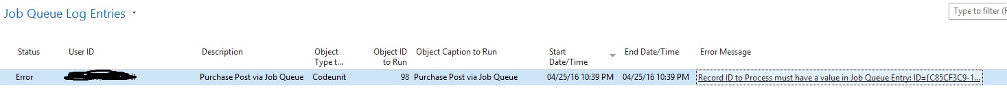

You can check the status of Running jobs using ” Job Queue Log Entries”.
