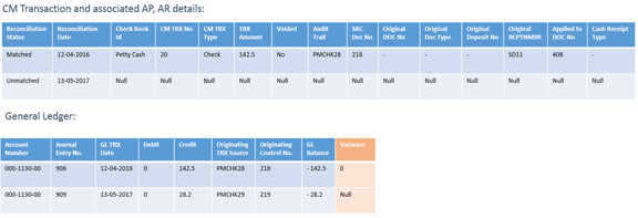

I have been working recently on developing a reconcile utility for previous GP versions. In this post, a script to reconcile check books to general ledger is provided (CM To GL). The script is still under testing as further revision version are required to stabilize its performance. Despite of its yet weak performance, it could still deliver a bit of an added value for those who are still living with the old versions of Dynamics GP. Of course, this is not to encourage them in any way to stay with old fashioned versions, but still better than nothing.
The script output in general is illustrated below;
Script Output
Digging deeper in the CM and GL parts, the following is more in depths output:
In details output
Helping Notes:
  • The script reconciles only one check book at a time, you can not reconcile more than one.
  • In order to run the script, pass the parameters required on the (Where) section which are
    • Checkbook ID
    • Month (Optional but recommended)
    • Year (Optional but recommended)
  • The script may have weak performance on large company database since it brings data from several GP modules (CM, AP, AR and GL)
  • Several additional GP modules have not been tested such as Payment Document Management (PDC), Schedule Payments and others.
  • As an initial test, the script below will run on (TWO) database (Fabrikam) and “Petty Cash” checkbook.
