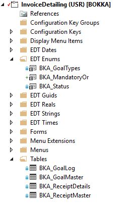

Error message while trying to build my project was: The underlying type 'BKA_Status ' or its base type for table 'BKA_GoalMaster' field 'GoalStatus' does not exist.
The underlying type 'BKA_GoalTypes ' or its base type for table 'BKA_GoalMaster' field 'GoalType' does not exist.</Message>
However, I had the 'BKA_Status' as well as 'BKA_GoalTypes' Enums already available in my project and even the project is Synchronized with the database.
Root cause:
To be honest, I was unable to find the root cause for sure. However, I imagine the error has something to do with the refresh of metadata because of the kind of solution which helped to resolve the error.
I have had 'Extends' property filled in with another Enum which was not existing in the Current model (or) the referenced models for a brief period. Later, I had cleared 'Extends' property before performing the build - and still ended up in the above error message.
