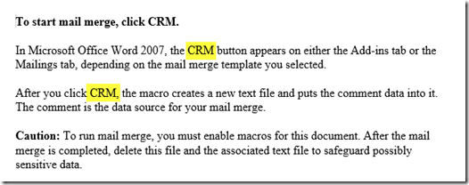

After that you download and open the Word file, you realize that you read this section…

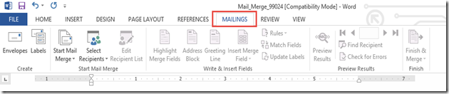

Then if in this case you cannot see the CRM button, you are probably facing the same problem with me right now, because I can’t see this icon.
*As we can see, in the ‘Mailings’ tab, there is no CRM button appearing.

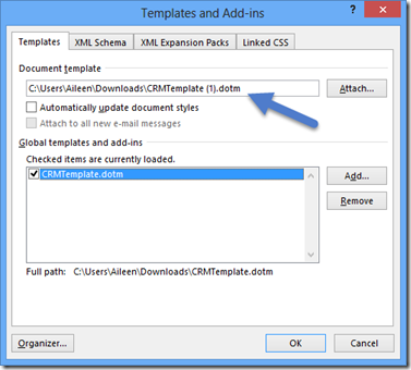

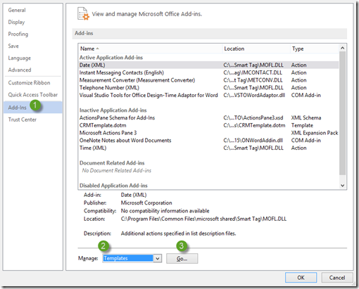

After that, you just download the Template and then go to the Options here in your MS Word App.
Just follow the steps above.
And then click Go…

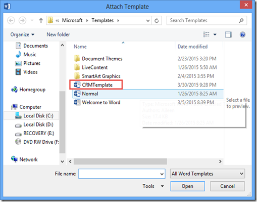

Then attach here:
Change the location to your template location.
Then OK.

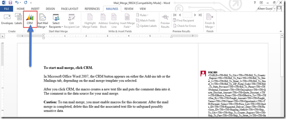

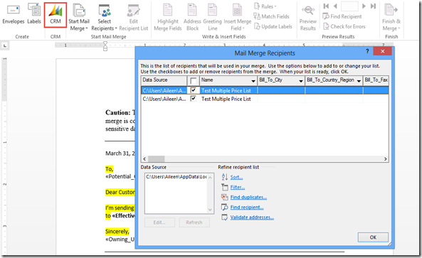

And here is the result
Result
*As we can see, there is the CRM button, the button that we have been waiting for to come in.
Note
You need to enable Editing + Macro to make it works.
Another tips, you can store the template to this location:
So that every time you open the File Location, it will be redirected by default to this location and you can just choose the CRMTemplate.
