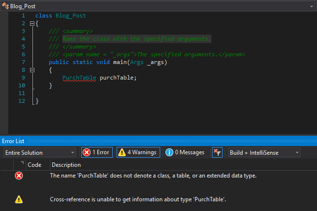

So what I have done is I create a new model and job (runnable class) in which simply I have Initialize purchTable object. As shown in image It throws compile time error and warning.

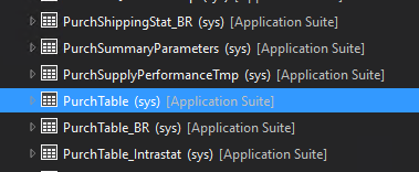

The reason of this error is that reference package for PurchTable object have not added in Current model. Shown in below images.
So for the resolution of this error all I have done is to check the ApplicationSuite Model (PurchTable Object Model), and build my current model which runs successfully.
