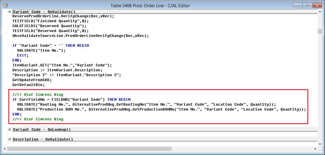

The above code change is all it takes to have production order that are refreshed to use the alternative production BOMs and routers. If you also want the same logic to happen if a user manually changes a production order line you need to insert the same code into the OnValidate triggers of the fields that are included in the logic. Wrap the code with ‘IF CurrFieldNo = FIELDNO(“Variant Code”) THEN BEGIN’ to not get a crazy circular reference. Something like below.
Code-Change-Prod-Order-Line-Table-2-Dynamics-NAV
