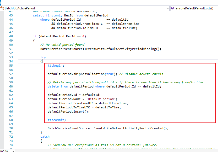

5. There is a default period define from 12:00:00 AM to 11:59:59 PM. Do not modify time or delete it , as system will check for a default active period and if this is deleted then system recreates it. The reference code can be found in below highlighted class.

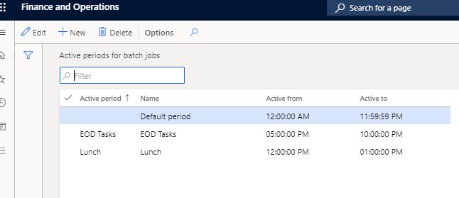

Active periods can be defined from System maintenance >> Setup >> Active period for batch jobs menu item
Multiple active periods can be defined as per the use case, it is very important for architects to discuss this with there clients and understand the need of batch jobs execution time frame:
