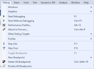

1) Go to debug menu and select attach to process option.

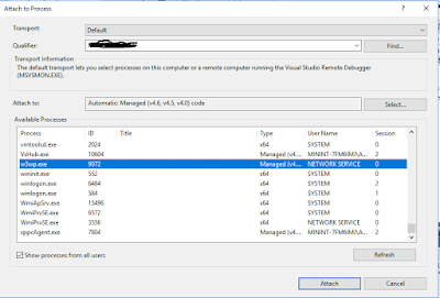

2) Select the batch.exe process and make sure show processes for all users is selected.
Note : Batch Service has name batch.exe and its location is (C:\CustomerServiceUnit\DOBind\Packages\Cloud\AosWebApplication\
AosWebApplication.csx\roles\AosWeb\approot\bin ) –at least on locally deployed machines
After attaching the process  symbols will be loaded. When you will execute your batch job at that time you will be able to debug X++ code.
