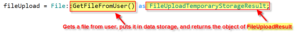

Step 1 is done by the below command where the file is uploaded from local machine to azure blob

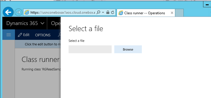

On running the job a file picker will be shown, where you can browse the file.
The progress of uploading it to cloud space is shown in the progress bar

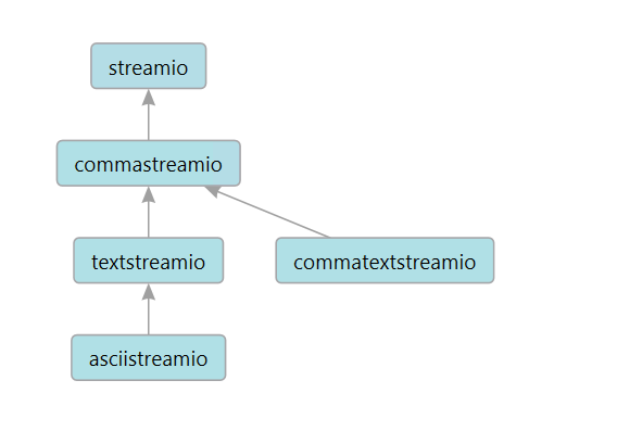

Worth mentioning that there are various other IO classes, provided out of the box which have the below associations
The file upload classes have different strategies and the below classes are available out of the box. For more information refer to nice articles mentioned in the references:

        fileUpload = File::GetFileFromUser() as FileUploadTemporaryStorageResult;
