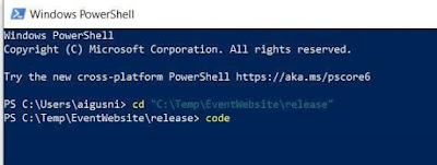

YES!! You don’t need to run Visual Studio App then open the project, you can just using PowerShell
I am using very simple PowerShell:
It then will open Visual Studio Code

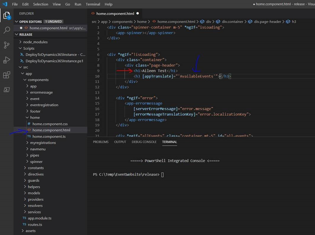

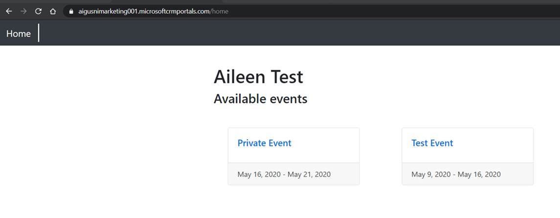

Let’s see you want to modify the Main Page like what I did for Aileen Test, you need to understand where is it being located in your Portal and the Source Code.
Do you know where is it??
Here is the default Marketing – Event Management Portal

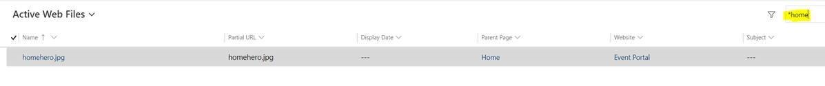

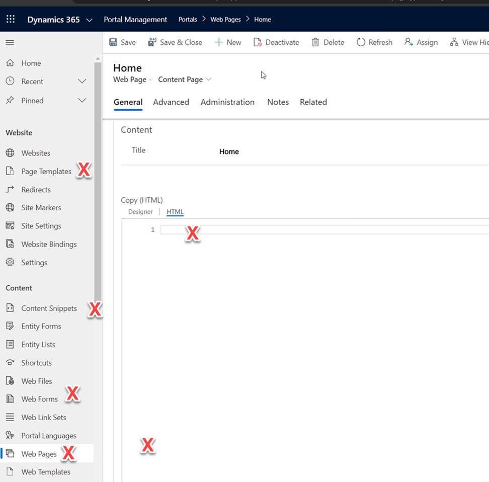

So, the first page is the All Events, I have been searching in any web files and any web/page template, code snippets in the Dynamics 365 instance but I got nothing.
I searched in the internet, I could not find it, and it is actually the way Angular works (P.S. I did not have much experience using Angular except for this one and PCF ) is by compiling everything and put it into main.js only.
Okay, since there is no much information, I tried to find it one by one and I tried to find “Available Events” keyword.
Have you found where it is??
Yes, it is behind the code!!
I found it in the home.component.html, which is located under src->app->components->home
However, you will not find it in the Home HTML in your Dynamics 365 instance just like old days of Portal. Not here, not there..
Not even here..
So, let’s just try and I will let you know where it is stored.
 Now, you want to change the color and add some words:

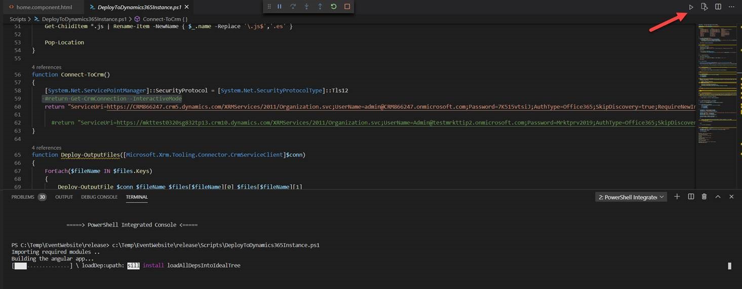

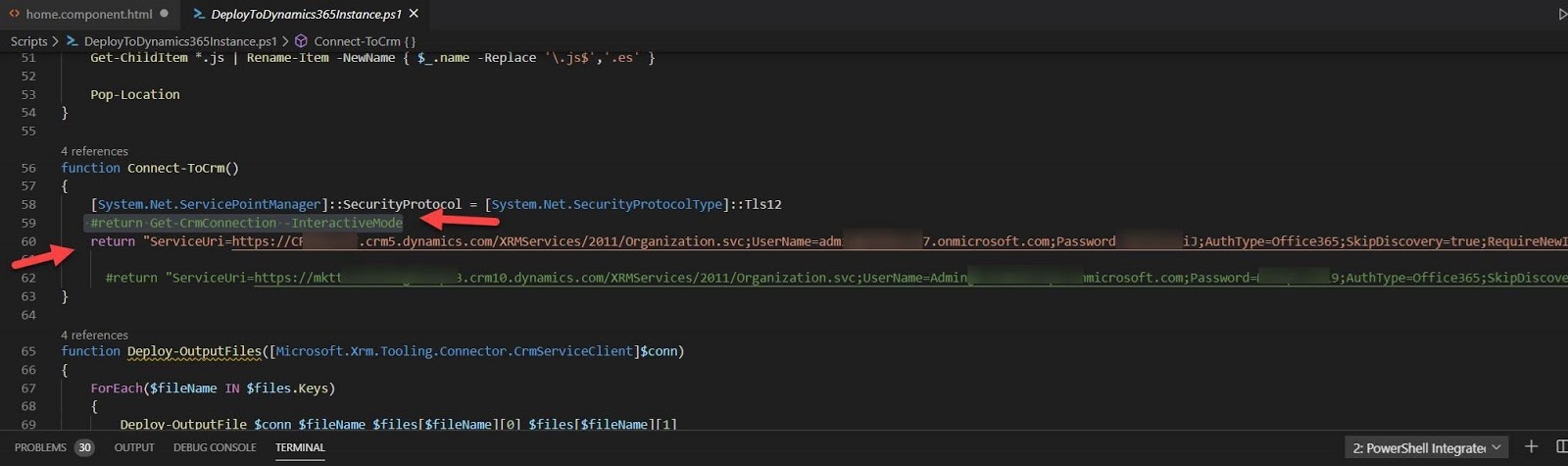

To deploy it, you need to go to the DeployToDynamics365Instance.ps1– it is located under Scripts folder
Then you need to change the Connection string or you can use InteractiveMode by uncomment it and comment the next return.
Remember in Powershell script # is comment not // or <!—or --

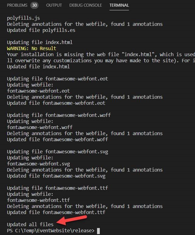

 Then after that you just need to Run/execute the script
I am using this button to run:
Wait.. and wait
then refresh your portal after you see this:

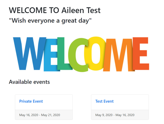

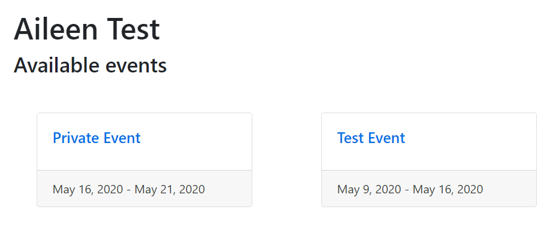

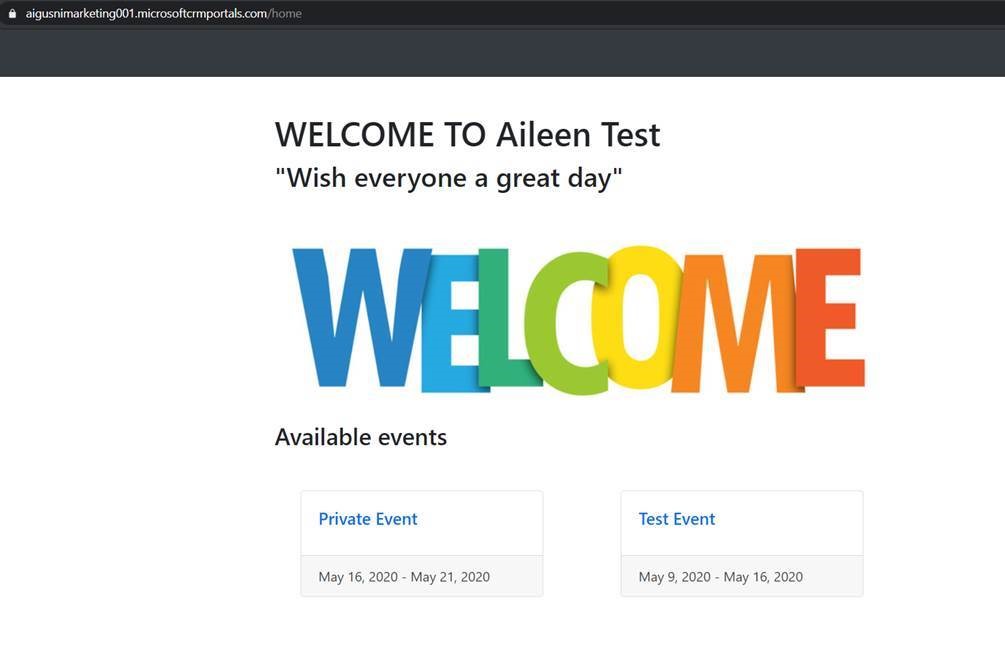

Refresh and here is what you will see (you may need to wait a while and keep hitting Ctrl+F5)
Before
After
Now you know how to customize it and deploy it LIVE to your Dynamics Portal.

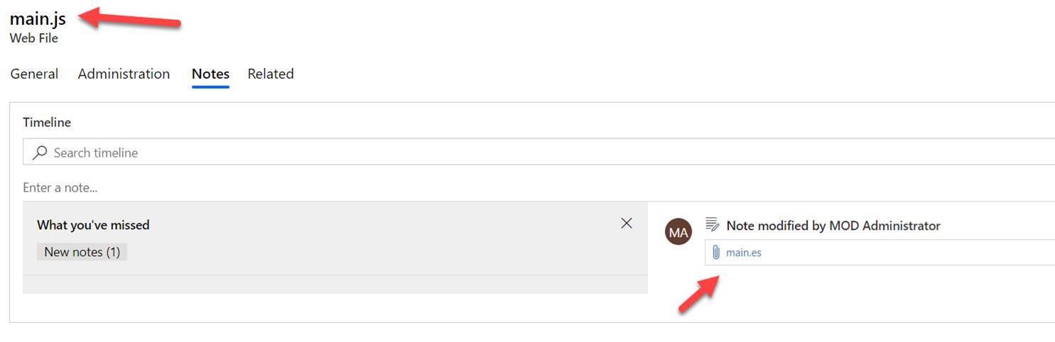

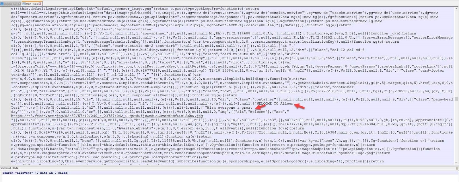

But, are you wondering “Where is my customization stored actually”?
Actually, it is inside the main.es file (Web files)
Hope this helps!
