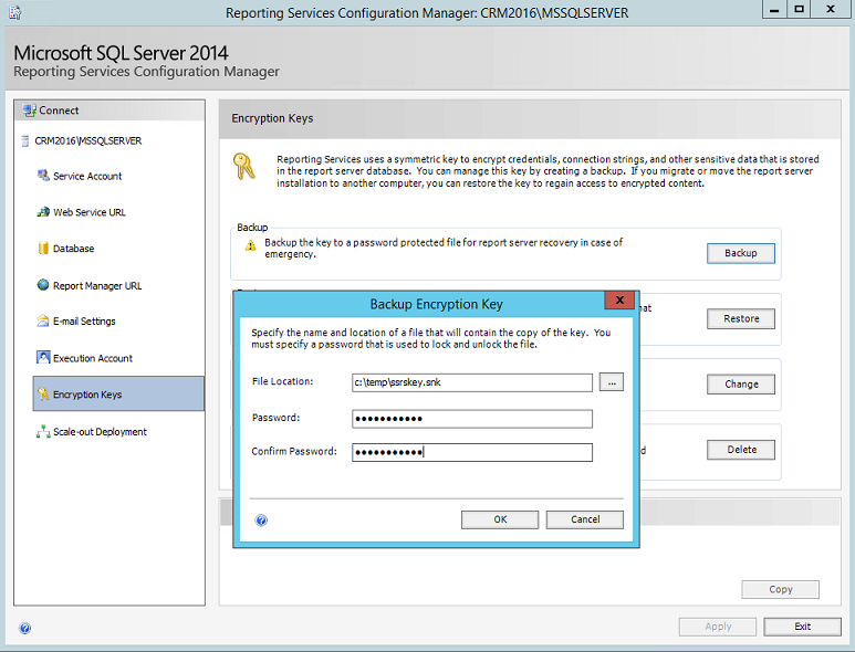

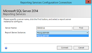

Log on to your SSRS server and open up the "SQL Server 2014 Reporting Service Configuration Manager" (assuming you're running SQL 2014). Select the report server instance you want to configure, which is the one you specified for CRM during installation (please note that the SSRS instance does not necessarily have the same name as the SQL Server instance CRM uses).

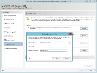

Navigate to "Encryption Keys" on the left hand side, and click the "Backup" button. You'll get a new window asking you where to store the key and to choose a password for it. Now, the key is a file you'll have to save somewhere safe. Now, I'm not going to promote practically free and safe storage in Microsoft Azure, but I would definitely put it in a secure storage area in Azure. The password specified for the file should be stored in your password management system, and if you happen to use MICROSOFT AZURE then you'll have a nice URL you can add to the password entry.</plug>

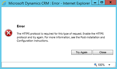

So how do you get the key when you aren't using HTTPS in your CRM environment? If you open up CRM and navigate to Settings -> Data Management and open up data encryption you will get this error:
So I'm going to guide you through how to get past this limitation without having to restarting anything.

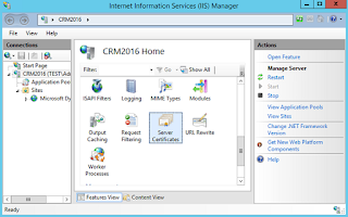

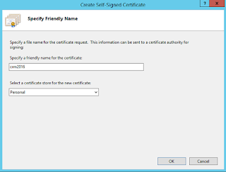

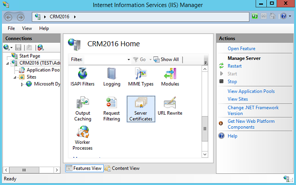

What you want to do add an additional binding to your CRM website, an HTTPS binding with a self-signed certificate. Head into Internet Information Services (IIS) and highlight the server, then open up Server Certificates from the home screen.

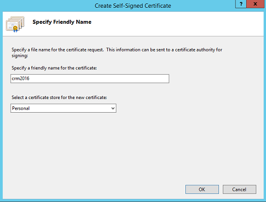

Open this feature, and on the right hand side click the "Create Self-Signed Certificate..." link, and you'll get a new "Create Self-Signed Certificate" wizard. Fill in the name of this certificate and click OK (both personal and web hosting will work).

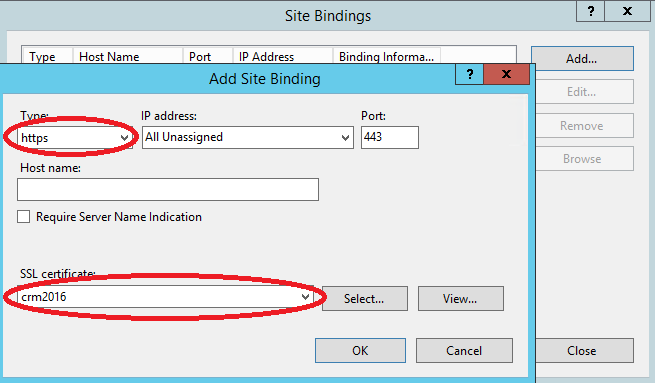

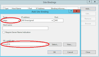

Now navigate to the Microsoft Dynamics CRM site in IIS from the left hand side, under "Sites". Click on the "Bindings..." link on the right hand side to get the site bindings configuration window. In this window, you will probably just have one binding beforehand, so click the "Add" button to add a new binding. Choose https as the type, the default port will be fine, and select the newly created self-signed certificate for use.

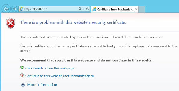

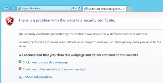

Click OK, then close, and from the right hand side just click the "Browse *:443 (https)" link to open up CRM with SSL encryption enabled. You will be presented with a warning screen which tells you that the certificate isn't trusted for this site, but that's OK because you just created this certificate yourself, and it's just for this purpose you're using it. Click on the red shield with the text "Continue to this website (not recommended)".

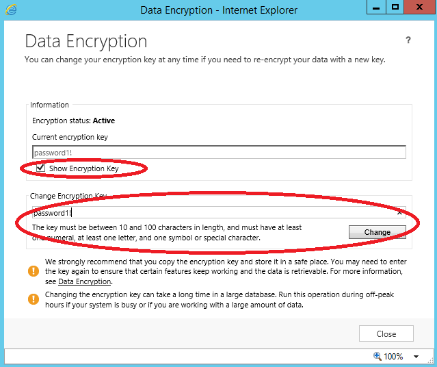

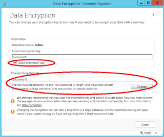

From the navigation bar, find Setting -> Data Management. Click on the "Data Encryption" option to open up the Data Encryption settings. And voila! You have the option to show and change the encryption key. The existing key will probably have alot of foreign characters (depending on your native language), and it's fine to keep it that way, or you can change to a new one. I often just generate a new Guid from powershell and add some additional special characters inside it, but as I said the default encryption key is pretty great considering that it's already all special characters. For this installation I'm going to change it into something that is NOT SAFE!

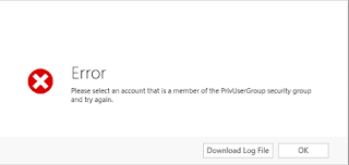

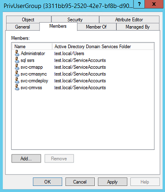

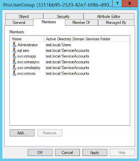

Now, you might get an error saying you're not part of the PrivUserGroup, if you did get this message then that means you'll have to add your user account to the PrivUserGroup corresponding to your organization, or find someone who can grant you that group membership.

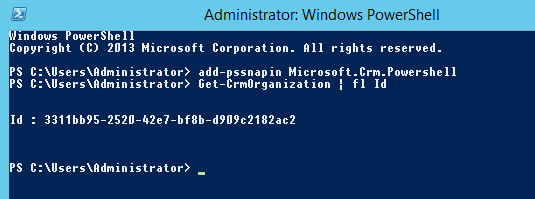

Beware, though, if you have multiple CRM deployments you will have several PrivUserGroup AD groups. To find the one you need to be added to, open up powershell and type in the following two commands:
add-pssnapin Microsoft.Crm.Powershell
Get-CrmOrganization | fl IdThis will list your organization(s) and give you the ID which succeeds "PrivUserGroup" in the group name.
