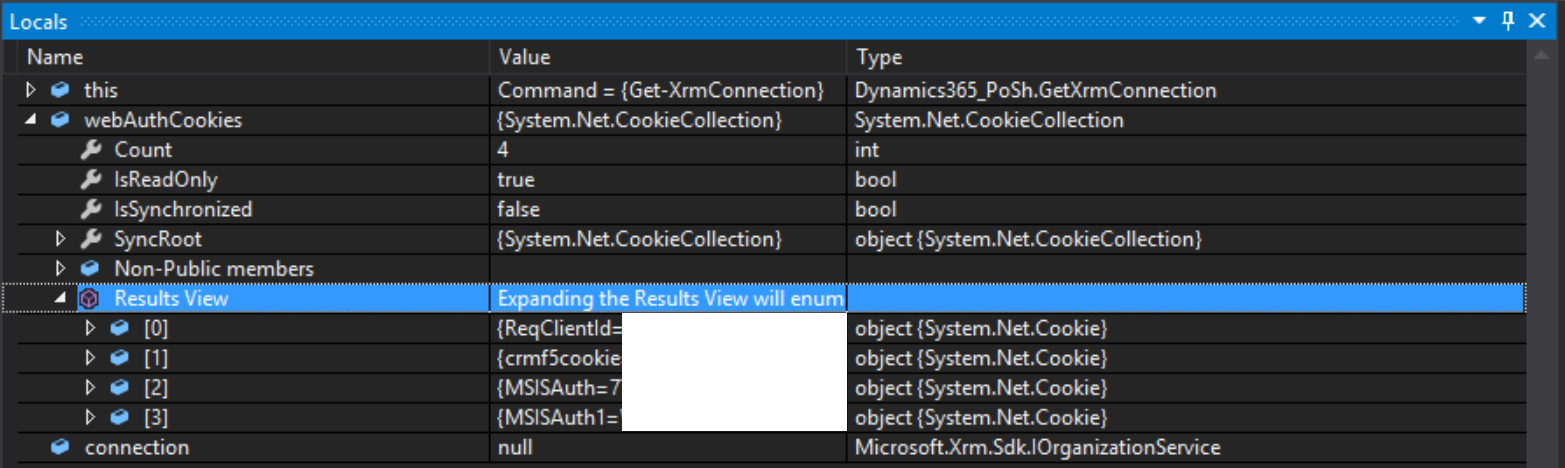

What happens next is that a windows forms window will pop up and navigate to the URL given. This will redirect to login.microsoftonline.com, and ask you for your credentials like you are used to. After you've logged in you will get the redirect to the MSDYN365 home page. When this happens "Navigated" event triggers, and then the "ClaimsWebBrowser_Navigated" method will close the form as the authentication is ended.
What we're left with is a cookiecollection which allows us to send authenticated web requests to MSDYN365
