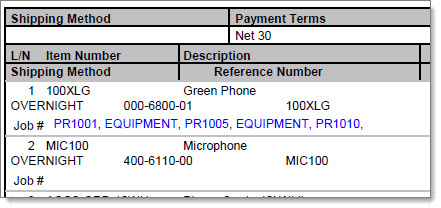

Here is an example of what the PO lines should look like:

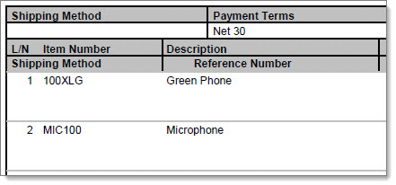

But here is what it looks like after the year end update is installed and the VBA code calls RetrieveGlobals9:
