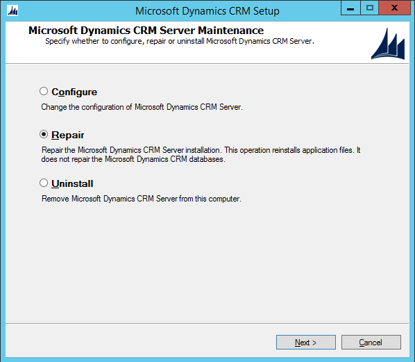

I referred a couple of blog posts and a forum thread and I tried to run Repair.
At the verification step during the Repair, I got the SQL Server with the error message "The instance name must be the same as computer name.". Since there is no step to update the SQL server instance name during the whole process before the verification step, the Repair process was totally stuck without any option.

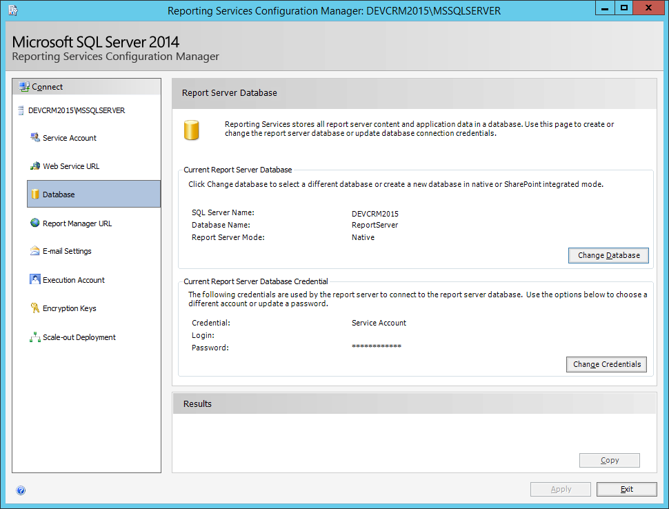

Even though CRM environment is working fine, you may still need to fix the DB connection string in Reporting Services from Reporting Services Configuration Manager.
