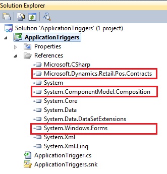

7- We need to add a few references. So right click in references and choose the one depicted in the figure in step 8
8- Import the following references.
9- Add the references depicted above to your .cs file as seen in the following picture. Also, the following picture shows the  IApplicationTriggers interface being implemented by our class. This is actually very important as without it, nothing will happen and you will not be able to run your AX 2012 POS application. Make sure your code looks as the one below.
10- Build the solution. By doing this, you are overriding the default ApplicationTriggers.dll dynamics library with the code in step 9. Make sure you don’t have any build errors.

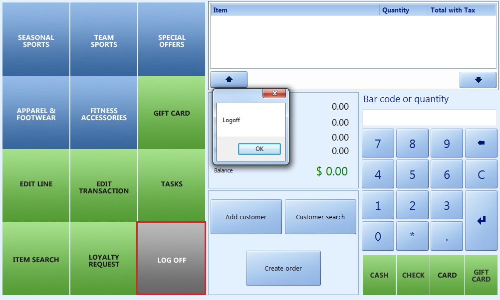

14- Click the Log Off button and you should see the following message.
The message above are executed from the public void LogOff() method.
