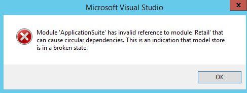

While working on a project, I imported an AxModel (D365) that caused me to have the following error when I tried to build the models.

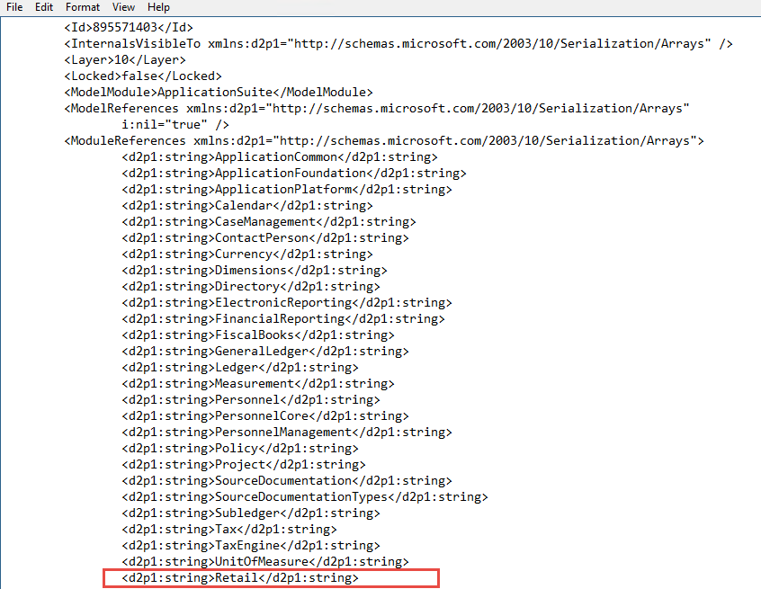

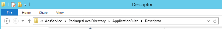

This has to do with a non-existing reference in the new module descriptor file. In my case, in order to solve the problem I went to the AOS Service / PackageLocalDirectory/Application Suite and opened the descriptor file.
I opened the file and searched for the "retail" keyword and deleted the line from the file and saved it.

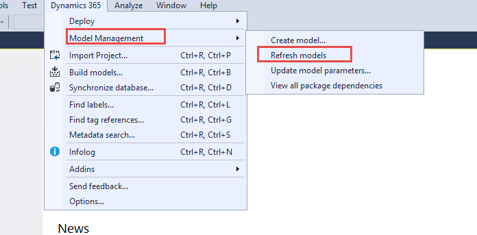

After deleting the line, I refreshed the models.
After that, I build the application again and I was able to keep working on my build.
