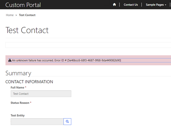

Recently one of our clients ran into issues with the Dynamic 365 Portal. As we were attempting to find a solution to the issues they were receiving we came across the error message shown in the below screenshot. As you can see, this is a very generic error and doesn’t provide us with much information. It was at this point that we decided to set up error logging for the Portal.

Now once you receive generic errors in the Dynamics 365 Portal you will be able to navigate to the Blob Storage account that you’ve connected and view more detailed error logs. An example of a log I had received when reproducing the error in the first screenshot can be seen below.
