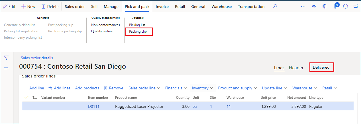

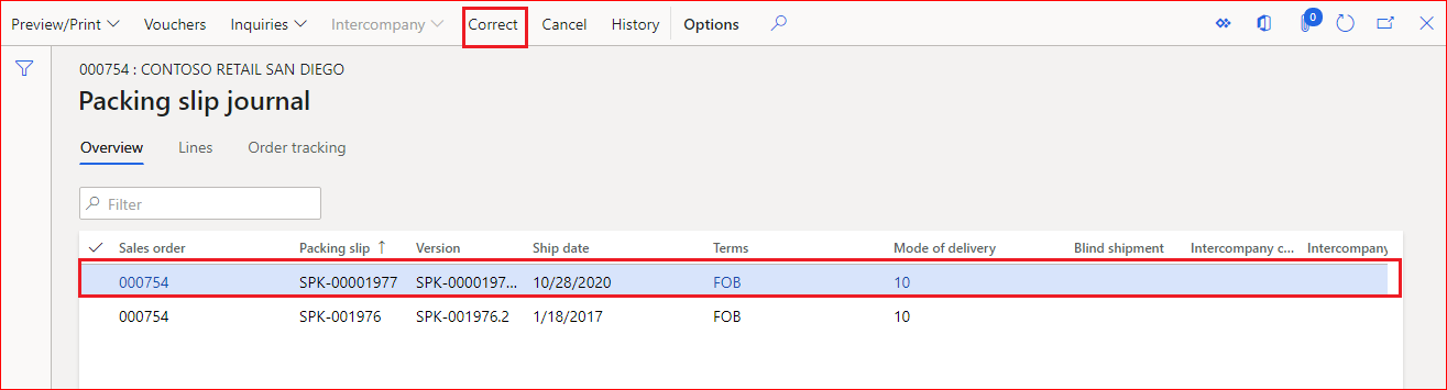

1. Go to the sales order --> On the action pane, on the Pick and pack tab
2. Click on Packing slip journal
3. Select the packing slip which was wrongly posted. You can see Correct and cancel buttons are enabled
4. Click on voucher --> You can see existing postings with the original packing slip
5. Now close the voucher form and go back to the packing slip --> Click on 'Correct' button
6. The packing slip correction form will open where you can edit the details which was wrong earlier

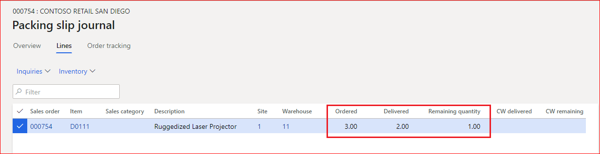

10. Upon correction, go to the same packing slip journal --> you can see that the delivered quantity is reduced from 3 to 2 and 1 quantity is shifted to remaining quantity field.

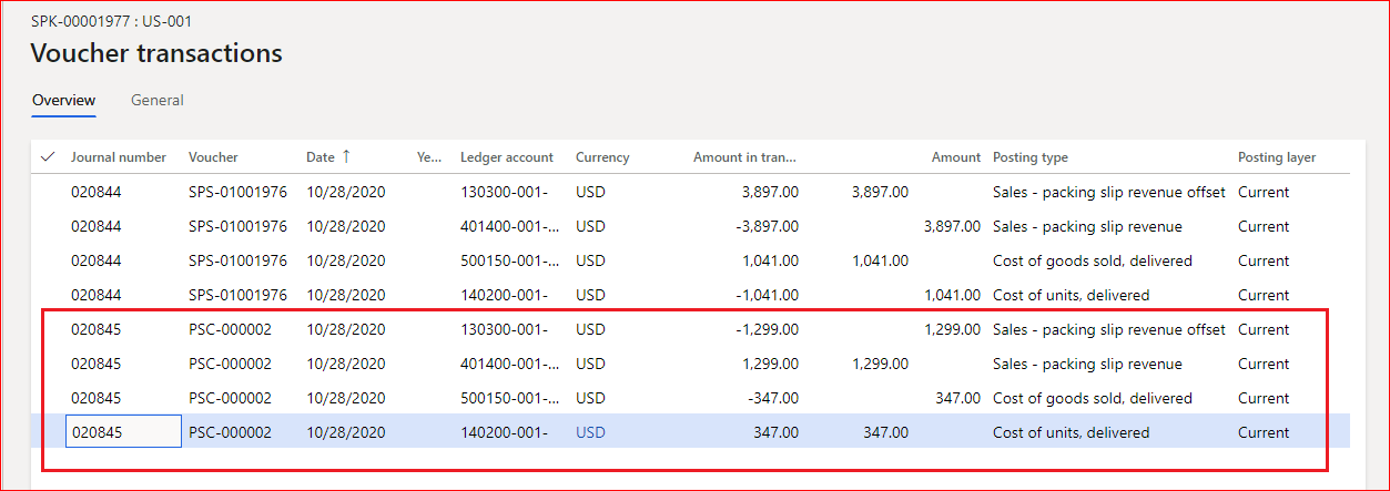

Overall system Impact (When quantity is corrected):
It reverses the postings of quantities which are getting reduced for the packing slip lines. It is as if new packing slip with reverse quantity for the corrected items is getting posted by the system automatically which will reverse the impact. Quantity which was supposed to be reversed (quantity to be reversed) for the item(s) will be reduced from the existing packing slip. This can be seen from the voucher of the same packing slip which was corrected where reversed postings will be visible for the corrected lines.

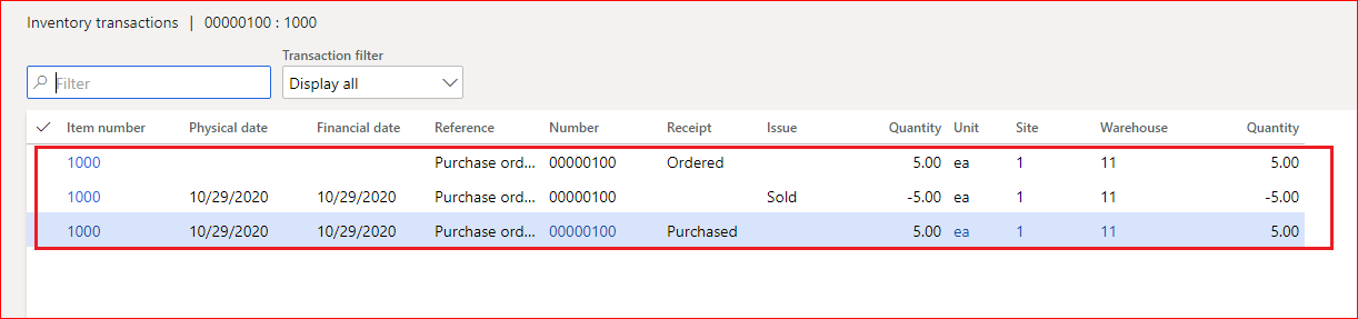

This reversing impact will also be visible from the inventory transactions for the corrected items. You can see inventory transactions that is posted to reverse the inventory impact.

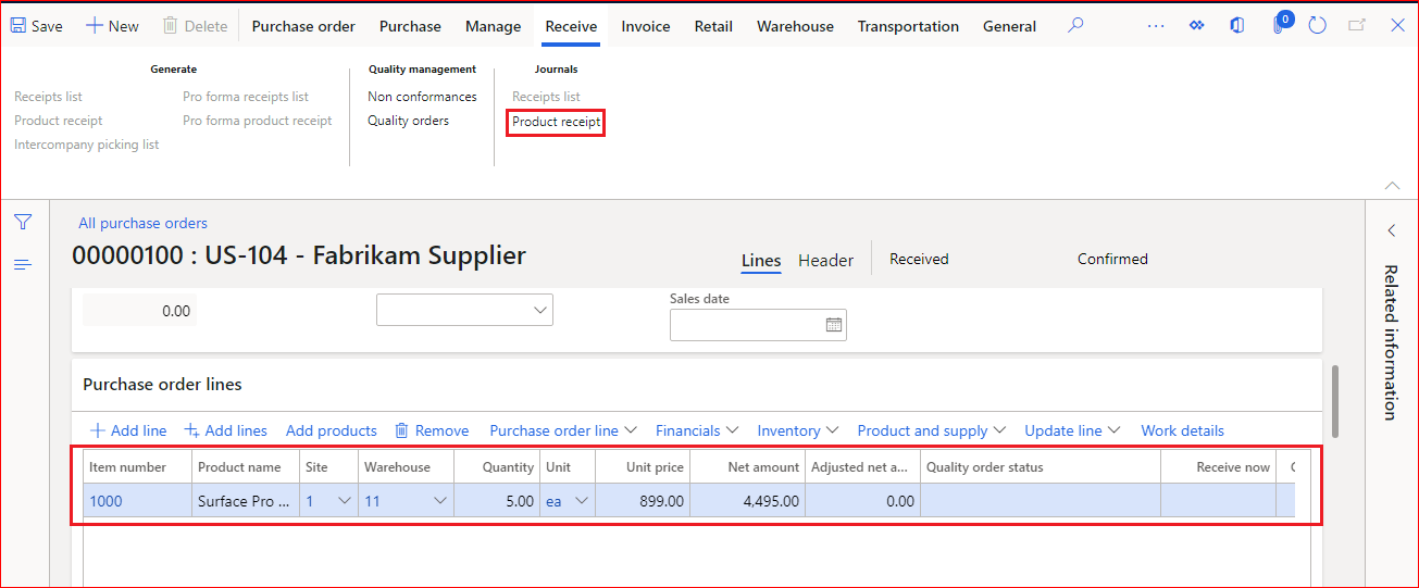

1. Go to the purchase order --> Receive fast tab --> Click on Product receipt journal

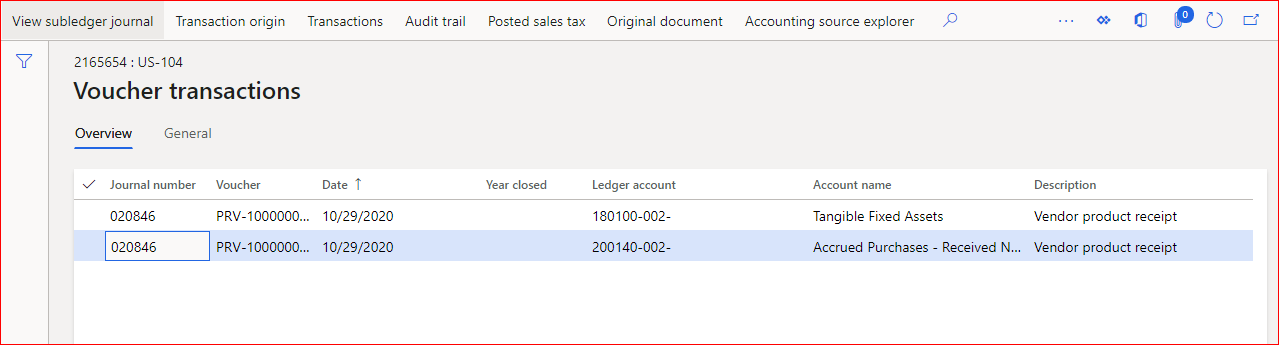

2. Select the appropriate journal --> Click on voucher --> you will see the postings against the product receipt which will be reversed with cancellation

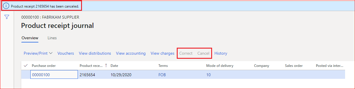

4. System will cancel the product receipt (Here the entire product receipt will be cancelled at once)
5. An infolog will appear with the confirmation of the cancellation
6. This will also disabled the correct and cancel button as it is no longer applicable for the cancelled product receipt

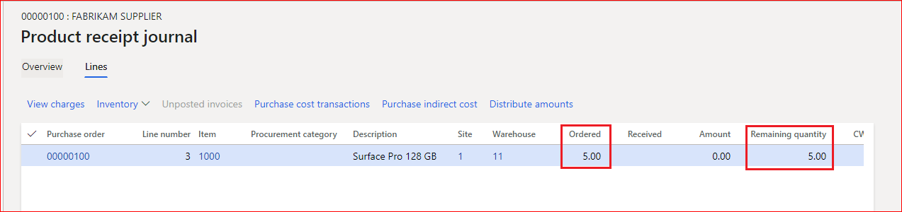

7. Upon cancellation, go to the same product receipt journal --> go to lines fast tab --> you can see that the received quantity is reduced to 0 and earlier received quantity is shifted to remaining quantity field for each line in the cancelled product receipt journal

It will reverse the impact of original product receipt. It is as if new product receipt with reverse quantity will be posted in the system automatically which will reverse the impact. This can be seen from the voucher transactions of the same product receipt where line with reverse quantity will be visible for each original line.
This reversing impact will also be visible in the inventory transactions for the items of the product receipt. You can see inventory transactions that is posted with reverse quantity than the original on the same date when original product receipt was posted.
