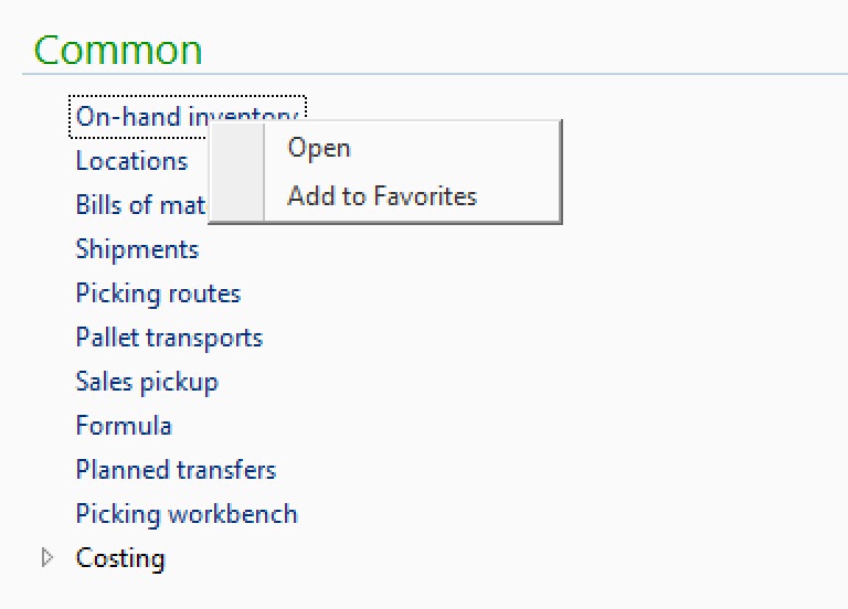

Since I am in the Inventory management module, I will add On-hand inventory to My favorites list first.
Navigate to On-hand inventory and right click on the link for On-hand inventory. You will receive two options: Open or Add to Favorites.
Right click to see Add to favorites
Right click to see the option to Add to favorites.

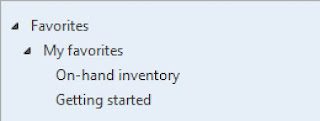

Select Add to Favorites. Nothing really appears to happen when you do this, but if you navigate back to your Favorites list, you will see that On-hand inventory has been added!
On-hand inventory has been added to the My favorites menu.
Newly added link to On-hand inventory in the My favorites menu.

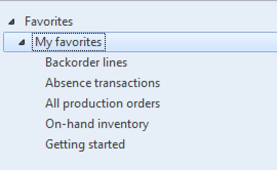

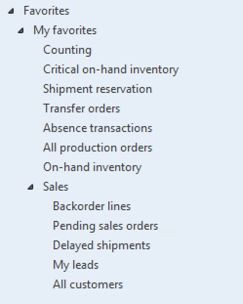

When all of the additional links are added that I specified above, my favorites will now look like this:
Favorites can hold links to objects, forms, list pages, and many other things in AX
Favorites can hold links to any item in any module in AX.

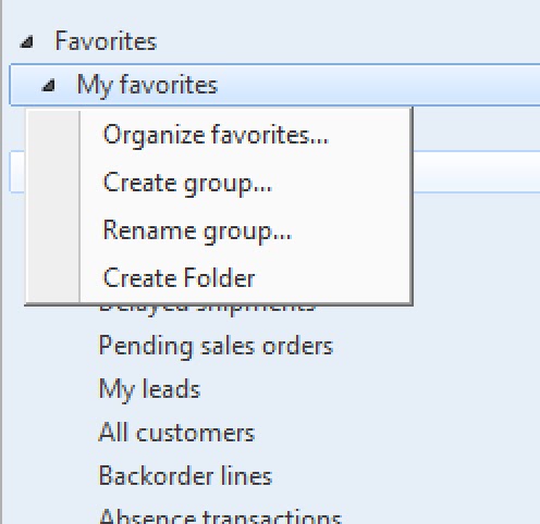

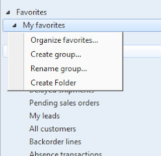

I can organize my Favorites by right clicking on My favorites. I am given the options to Organize favorites, Create group, Rename group, and Create folder.
Listing of multiple ways to organize favorites in AX
Multiple ways to organize Favorites in AX.

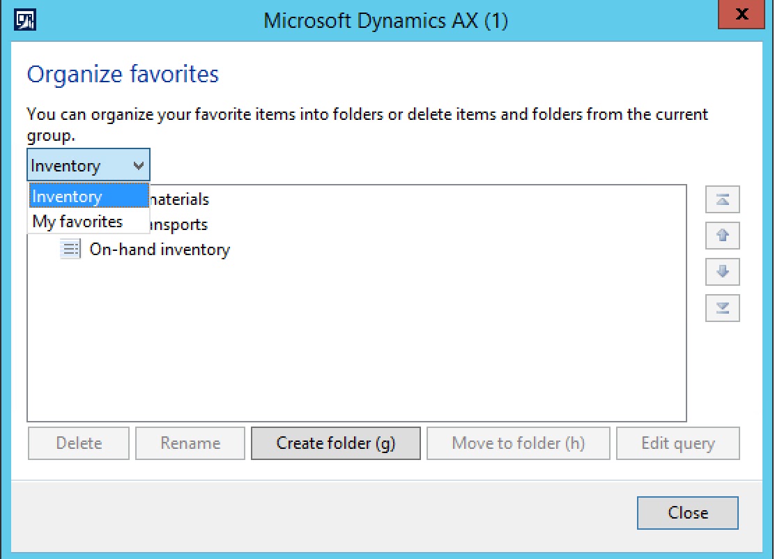

If I select Organize favorites, this will open a new window that gives me every option available to allow me to organize how my Favorites are listed. I can delete links that I no longer need. I can rename my links to something that makes sense to me, for example, if a link to a report is named the same as a link to a list page, I can add Report to the end of the link name that goes to the report. I can also create folders from here and move Favorites into folders. Basically, selecting Organize favorites will give you every option you need to set up your favorites how you'd like to see them.
Organize favorites easily in the organize favorites form in AX.
Organize favorites easily in the Organize favorites form.

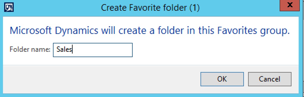

Within the Organize favorites form, I can create a folder, or I can do this from the My favorites listing. When I select this, I am given the option to Create Favorite folder. I am going to create a folder called Sales for all of my sales related links in AX.
Creating a folder called Sales for all sales related items.
You can create as many folders as you would like to organize your favorites.

After I move all of my sales related links into this folder, My Favorites will now look like this:
Listing of favorites with Sales folder inside. A lot more organized!
My favorites list looks a lot more organized now!

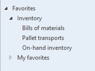

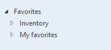

Another option within Favorites is to create a new group. This will actually create a new group that is on the same level as My favorites. to demonstrate, I have created a group called Inventory.
I created a group under favorites called Inventory.
Creating a group called Inventory for all Inventory related Favorites.
Groups that are added into favorites are on the same level as My favorites.
Groups are added on the same level as My favorites.
As you can see, I now have a group called Inventory in addition to My favorites. This is a little bit trickier to navigate. In order to add to this group, it must be on top and I will right click on whatever I need to add to it and click Add to favorites. This will act like it is my default Favorites group and everything will now be added to it.
Items have been added to the Inventory group in AX.
Now the Favorites list in AX is starting to look really good!

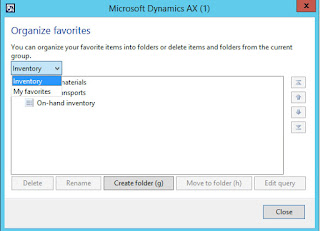

I can access this group and organize it from the Organize favorites window. I also have the option to organize both groups from here. I can also easily move items between groups by selecting the item I want to move and clicking on the Move to folder button.
Inventory and My favorites can be accessed from the Organize favorites form.
I can now access either group in the Organize favorites form in AX and add items from one to the other easily here as well.
