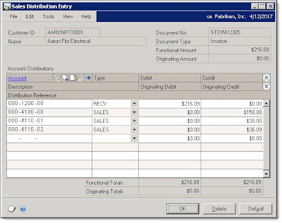

Dynamics GP has transaction "distributions" that are child records for a transaction. So for this customization, we could adjust the distributions, add lines, and remove lines to direct amounts to the appropriate sales accounts.
This screen shot shows an invoice with three different Sales distributions that I entered manually. The $216.09 can be spread across as many sales accounts as desired. This can be accomplished with one of the development tools and / or SQL. These changes are saved with the invoice, and when the invoice is posted, these distributions are posted to the General Ledger. For Dynamics GP consultants, this is probably fairly obvious and makes sense.

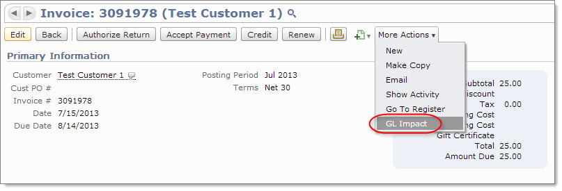

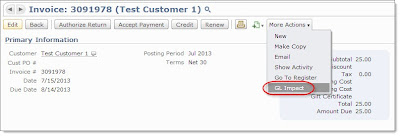

Once you save the Invoice, you have the opportunity to view the "GL Impact" of the Invoice transaction.
The GL Impact window lets you see the GL accounts and amounts for the transaction, but the information cannot be modified.
