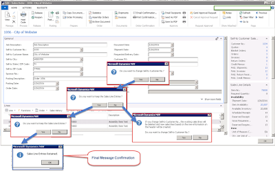

It also gives us option to handle the continuous process which are dependent and needs series of input (Confirmation) from the user. Please refer the image below.
In this Example i have used the series of Confirm dialog box to achieve a goal to retain the Sales line record. The Message should be informative enough for the user to understand the process and select the right choice. This is very friendly if used properly.

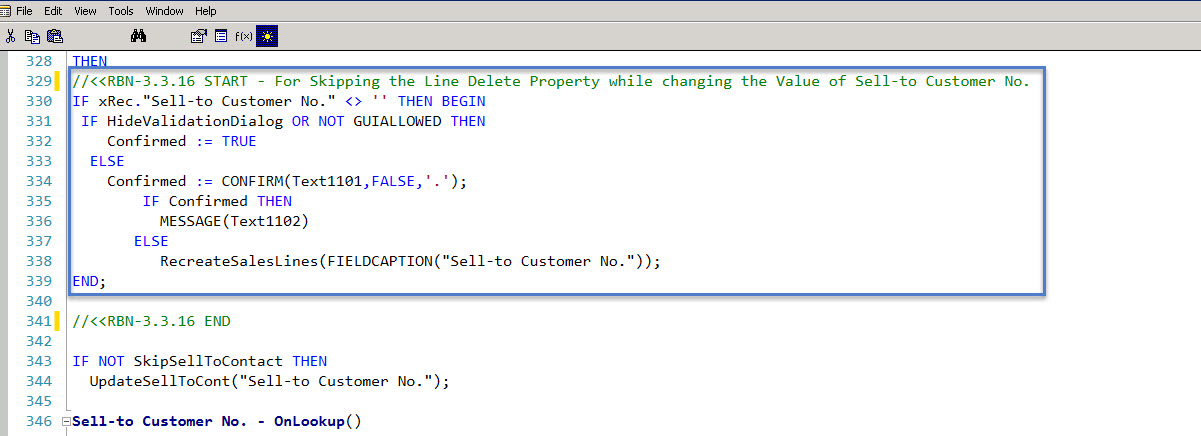

Confirmed := CONFIRM(Message,[Value],'.');
Example:
//<<RBN---
IF HideValidationDialog OR NOT GUIALLOWED THEN
Confirmed := TRUE
ELSE
Confirmed := CONFIRM(Text001,FALSE,'.');
IF Confirmed THEN
//If Condition
ELSE
//Else Condition
//HideValidationDialog---->Boolean
//Confirmed----> Boolean
//Message[Text001]---->Message for Dialog Box. Eg: Do you want to do ____
//>>RBN---

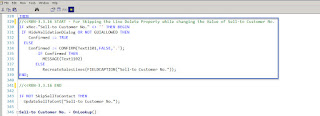

Code Screenshot:
