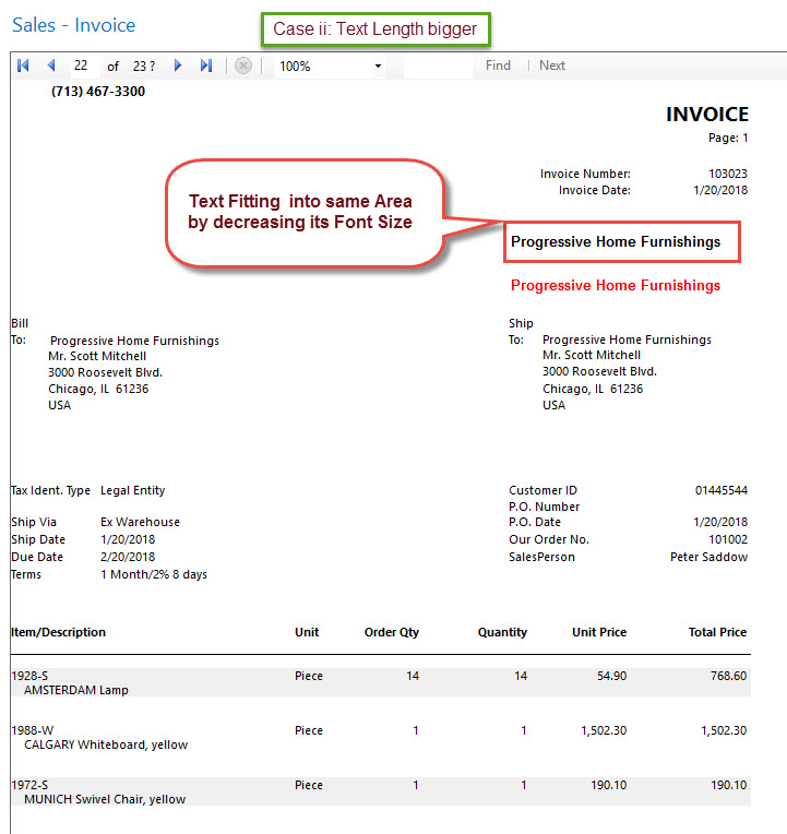

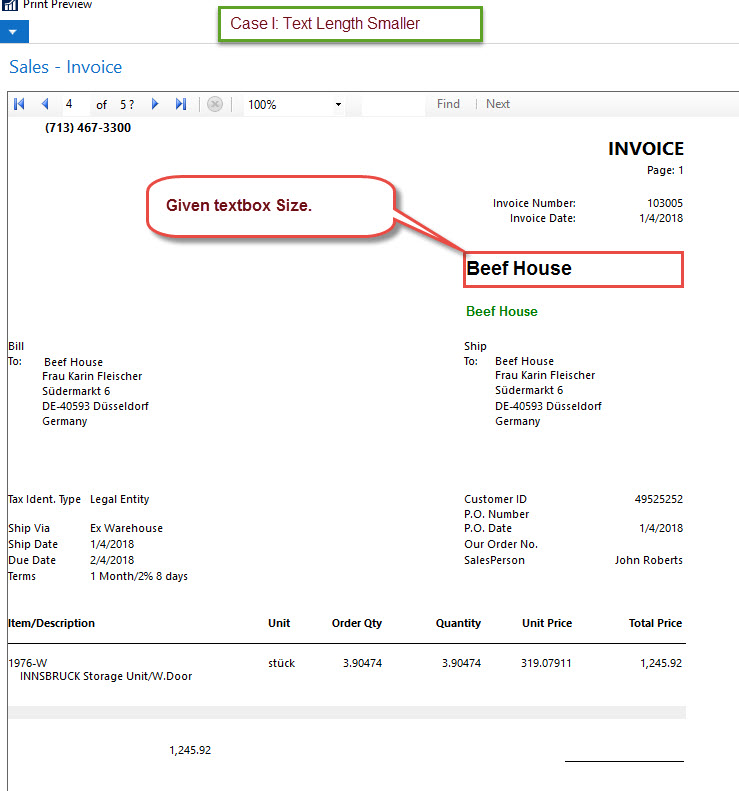

TEST CASE I: Text length is small - So It can keep its Original Size [14 Pt]
TEST CASE II : Text length is Larder to fit in the area with same Font so it was adjusted to [10]

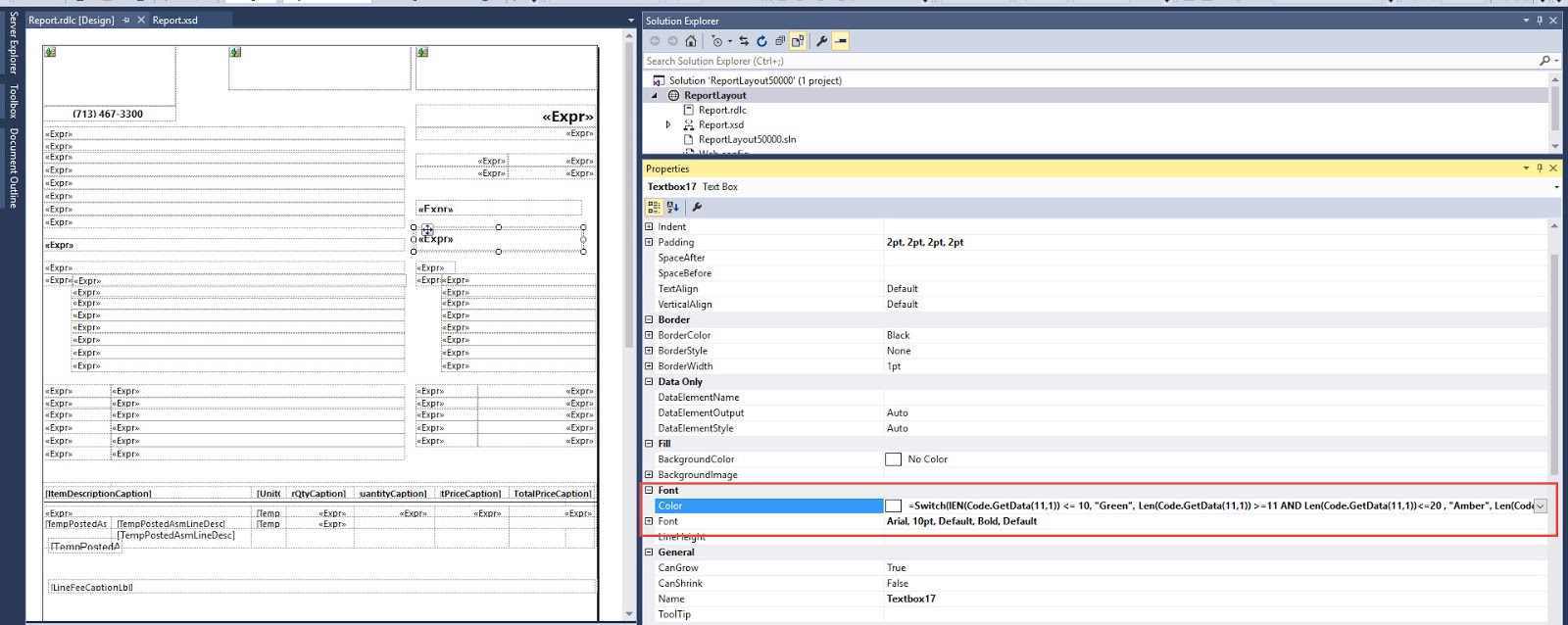

<Solution>
Its as simple as IF/Else Condition in CAL Code.
Code Syntax:
//Using IIf Condition
IIf(Len(Variable_Value) <= Lenght,“True_Value Pt”,“False_Value Pt”)
Example:
//Using IIF Condition for Size
=IIf(Len(Code.GetData(11,1)) <= 10, “pt”, “16pt”)
Alternative: =IIf(Len(Field!DatasetVar.Value) <= 10, “pt”, “16pt”)
//Using Switch Case for Size
=Switch(Len(Code.GetData(11,1)) <= 10, “14pt”,
Len(Code.GetData(11,1)) >=11 AND Len(Code.GetData(11,1))<=20 , "10pt", Len(Code.GetData(11,1)) >20 , "5pt")
//Using Switch Case for Color
=Switch(Len(Code.GetData(11,1) <= 5, "Green",
Code.GetData(11,1) >=10 AND Code.GetData(11,1)<=15 , "Amber", Code.GetData(11,1) >15 , "Red")
Note: We can use the Same type of Code for Color and other related property of Text.
