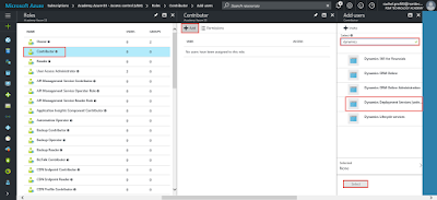

Before you can add ARM enabled, cloud hosted environments to an LCS project, you will need to grant access within Azure to the Dynamics Deployment service. The following procedure shows how to add the security access in the Azure subscription.
1. Go to portal.azure.com
2. Log in with your credentials.
3. In the Azure Portal click More services at the bottom of the Navigation Pane.
4. Click Subscriptions.
5. Click the Subscription in the list that you want to update.
6. Click Access control (IAM) in the Subscription navigation pane.
7. Click Roles on the right pane.
8. On the Roles page, click Contributor in the list.
9. In the Contributor pane, click Add.
10. In the Add users pane, type dynamics in the Select box.
11. Click Dynamics Deployment Services from the list.
12. Click Select.
13. Once the security is added, a message will appear. Close the Roles pane.
