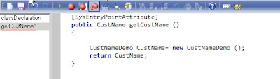

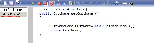

6.       Create another class.
7.       Create a method that instantiates the class created in Step 2.
8.       Enhance the class that uses the [SysEntryPointAttribute] attribute.

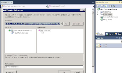

Ok, so at this point we should have our new AX 2012 service already working. The next step is to learn how to use this service from Visual Studio 2010. Please refer to this article if you are new to adding services references to Visual Studio. It will help you understand the underlying concepts of this operation.
1.       Select File > New > Project to create a new project of type Console Application.
2.       Enter a name into the Name field and then click OK.
3.       Right-click the Service reference node under the project.
4.       Select Add Service Reference.
5.       Enter the address and then click GO.
6.       Select the service and then click OK.
NOTE: The address format in step 5 is http://<machinename>:8101/DynamicsAx/Services/Xpp.
7.       Invoke the service from the client.
8.       Click F5 to run the service.
As you can see, when you run the service, the first customer name that are available in your system will be presented as an output.  There is a lot more to services and you can start learning more about it by going to partner source and/or downloading the new AX 2012 white papers focusing on services.
