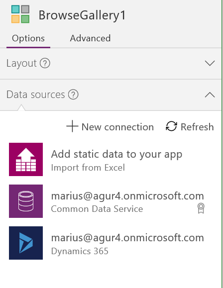

Now this is the easiest part. To connect with MSDYN365 in your powerapp simply go to the 'Content' tab and select Data Sources, and you'll be presented with the option to add new connections and data sources. Here it will probably show you something like this (I have a completely new trial organization with only O365 E3 and MSDYN365 Plan1:
What I'm doing is connecting to the MSDYN365 suggestion, and I'm going to add 3 tables (entities) to my data source list; Accounts, Contacts and Users (systemusers).

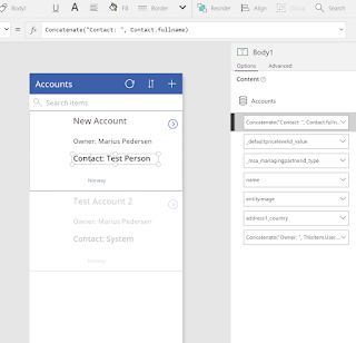

Now we've got a search gallery were we can search for accounts and get the related primary contact and the owning user data values. We can use that to further style our result list so it will look something like this:

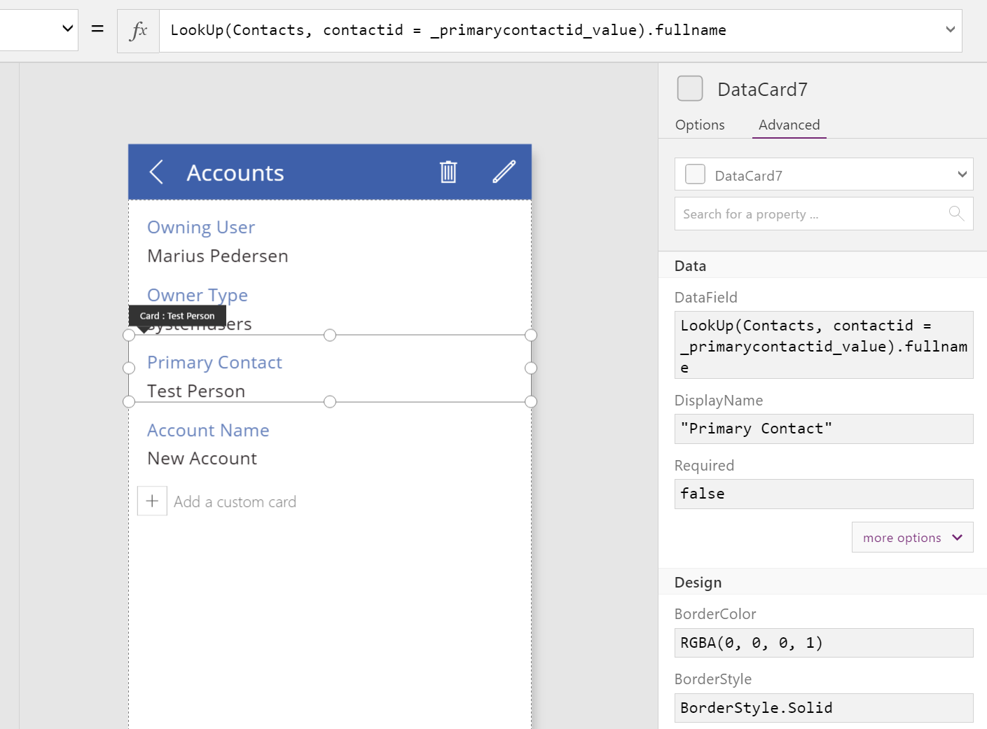

So now that we've got the data available we can start adding the fields to the forms. If we want to have some fields from related records we can simply use the LookUp function to get them. For example, if I want the full name of the primary contact I can use this formula in a data form:
LookUp(Contacts, contactid = _primarycontactid_value).fullname
So now that I've done a very small amount of customization my detail form looks like this.

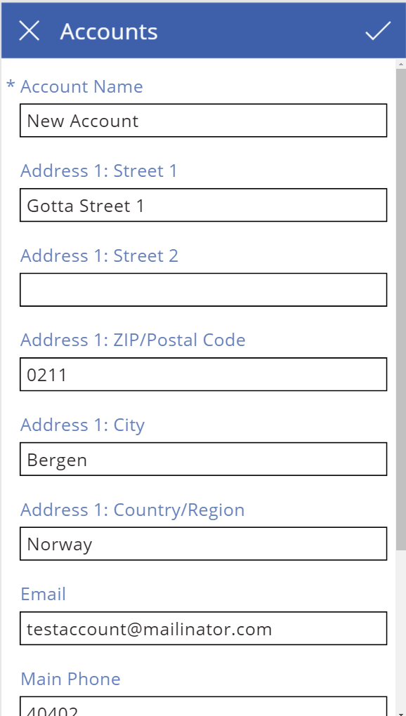

So now we're ready to do some customization to the edit form. I've gone ahead and added the same data source and item as we did on the detail form, and I've added the address fields just so we have something to play with. The results so far looks like this:

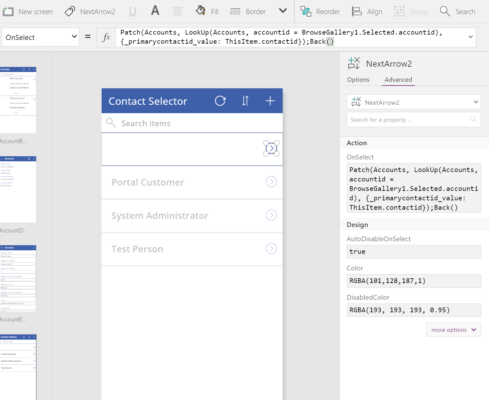

Now the right arrow on each result will usually try to navigate to a details window, but we don't have that window here and we don't want to see the details either, we just want to add this contact as the primary contact to the account. So what we're going to do is to use the "patch" function in PowerApps. The Patch option allows you to edit items on an existing record, while the update function replaces an old record with a new one. Since we just want to update the contact I'm going ahead with the patch method. The syntax for the patch function is like this:
Patch(<data source>, LookUp(...), { field1: value1, field2: value2})
So we want to update the account we have selected in previous windows. In additon, we want to update the primary contact Id for that account. That means we have to do a formula like so:
Patch(Accounts, LookUp(Accounts, accountid = BrowseGallery1.Selected.accountid), { _primarycontactid_value: ThisItem.contactid})
This is starting to look pretty nice, but we also want to navigate away from this form after updating. To do that we simply add a semicolon after the Patch function, then call the Back() function to go to the previous window. What we end up with is a window that looks something like this:
