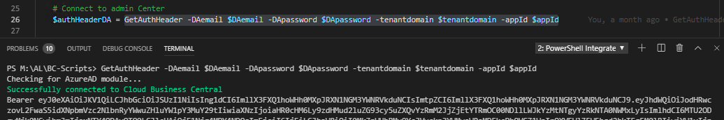

$url ='https://api.businesscentral.dynamics.com'
$authHeaderDA = GetAuthHeader -DAemail $DAemail -DApassword $DApassword -tenantdomain $tenantdomain -appId $appId
Get-BCCloudAvailableVersions -url $url -authHeaderDA $authHeaderDA

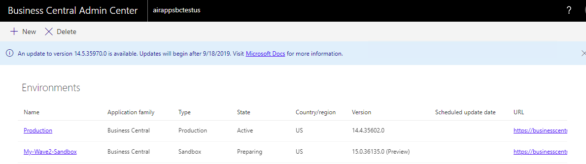

The result will be
and in the Admin portal

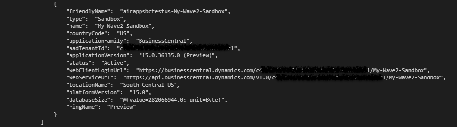

Get the list of installed environments in the tenant
During the spin-up process, or afterwards, we can get the list of installed environments in your tenant with the environment status.
$sandboxName = 'My-Wave2-Sandbox'
Get-BCCloudEnvironments -url $url -authHeaderDA $authHeaderDA -envName $sandboxName | ConvertFrom-Json | ConvertTo-Json
function Get-BCCloudEnvironments {
    param (
        [Parameter(Mandatory=$true)]
        [string] $url,
        $authHeaderDA,
        $envName
    $req = $url    '/v1.2/admin/applications/BusinessCentral/environments/'   $envName
    $result = Invoke-WebRequest `
                                -Uri   $req `
                                -Headers @{Authorization=$authHeaderDA} `
                                -Method Get
    $result.Content
with the output
If you notice, there is a Status parameter that we will use.
