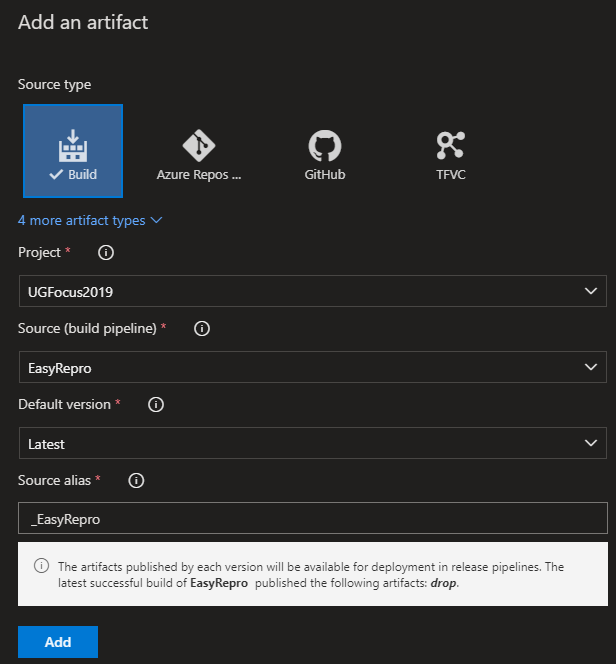

In order for ADO to be able to run tests on demand we need to create a release pipeline. Again don’t start with an existing template, just pick the empty job. Select Artifacts & Add and then choose Build and use your project and the build pipeline you just created as the source. You have a few different options for the default version to use but I’d probably set it to use the latest each time.

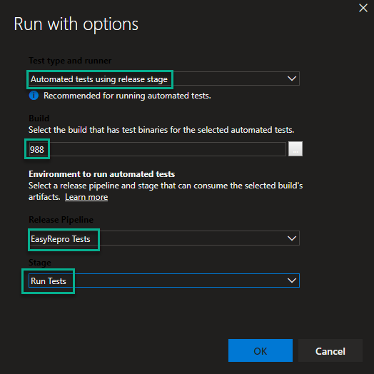

If you aren’t able to edit the test plan you can use Run with options and it will open a window where you can choose the items that got configured when linking at the test plan leave. When selecting the build the user will need to either know the build number or know enough to select find and the pick the correct (likely the most recent) build and pipeline from the list.
