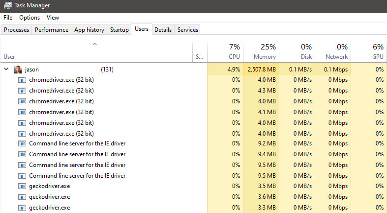

When developing tests using EasyRepro there are going to be plenty of times during the debugging process where you end up cancelling before the test runs to completion. When that happens the WebDriver for the browser you're testing on doesn't have the chance to shut down properly. The most obvious result of that is the browser being left open. Annoying, but easily fixed by just closing it. The other hidden side effect is that you end up with a number of leftover processes left open on your machine.
Probably not going to grind your machine to halt but it would be better if those processes got cleaned up without having to remember to manually go through and End task for every single one of them.
Fortunately there an easier (albeit not perfect) way to handle this. With a few lines of code you can check the running processes and stop any offenders. You'll notice that I added the code to the AssemblyInitialize method and not AssemblyCleanup. In a perfect world you'd do the clean up at the end after all tests have run. Unfortunately that won't work here, in the event you cancel a test or abort in some way AssemblyCleanup doesn't run. The next best thing is to run the clean up code before starting a new run of tests. Once this is in place you shouldn't have more than 1 process leftover at any given time.
