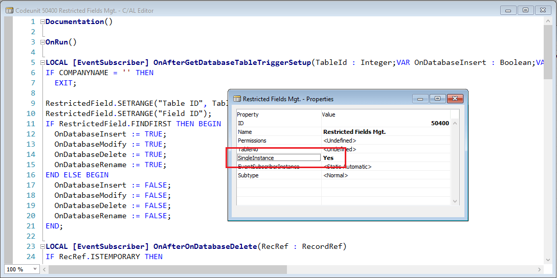

We also make the codeunit a single instant codeunit and put the two new tables in it as global variables. This will reduce the number of reads that NAV will have to do from the database since the two tables will then remain in memory during the client session. This is the same way the change log codeunit is structured.
Single-Instant-Restricted-Fields-Codeunit-Dynamics-NAV-2016
The code in the OnAfterGetDatabaseTableTriggerSetup function just returns true if the record that is being changes is in a table that have a restricted field. Returning true will make NAV call the OnAfterOnDatabase functions, otherwise those are not called (same concept as the change log again).
OnAfterGetDatabaseTableTriggerSetup-Restricted-Fields-Codeunit-Dynamics-NAV-2016

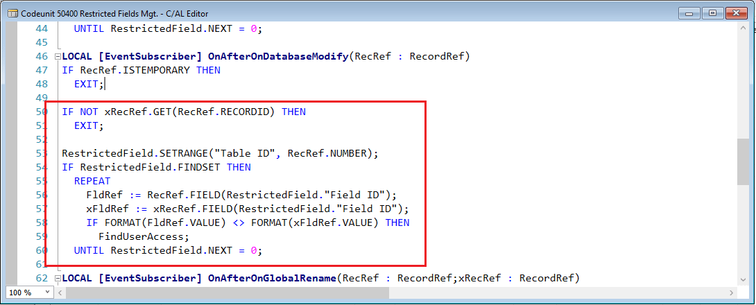

Then in the other functions we just compare the value of the restricted fields on the record being changed with the record that is in the database. We do this using RecordRef and FieldRef variables, the key here is that the record we get from the database is the ‘unmodified’ record that we can compare with, and we are only comparing the restricted fields.
OnAfterDatabaseModify-Restricted-Fields-Codeunit-Dynamics-NAV-2016

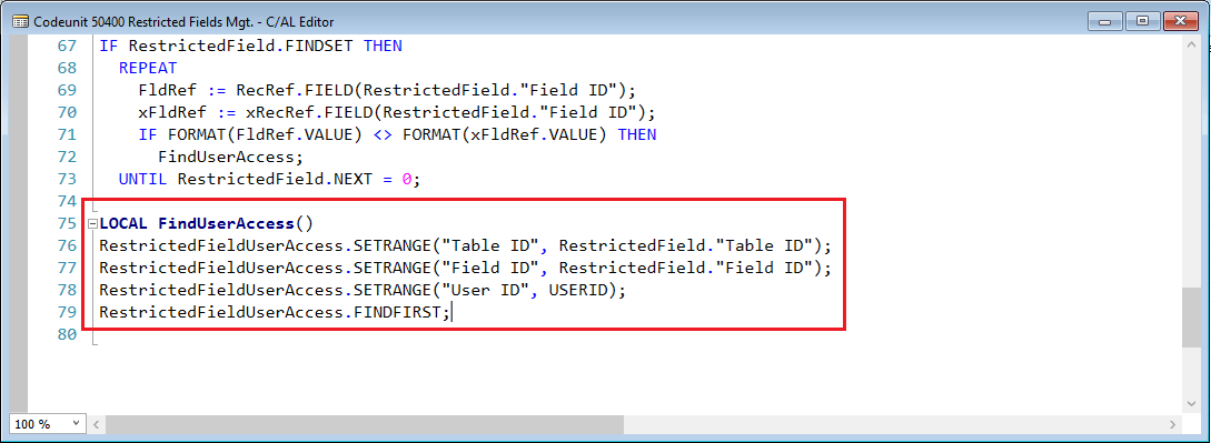

And if the value is different we check the user access like below (if the user is not setup to allow modifying the field NAV will throw an error znd rollback the change).
FindUserAccess-Restricted-Fields-Codeunit-Dynamics-NAV-2016
