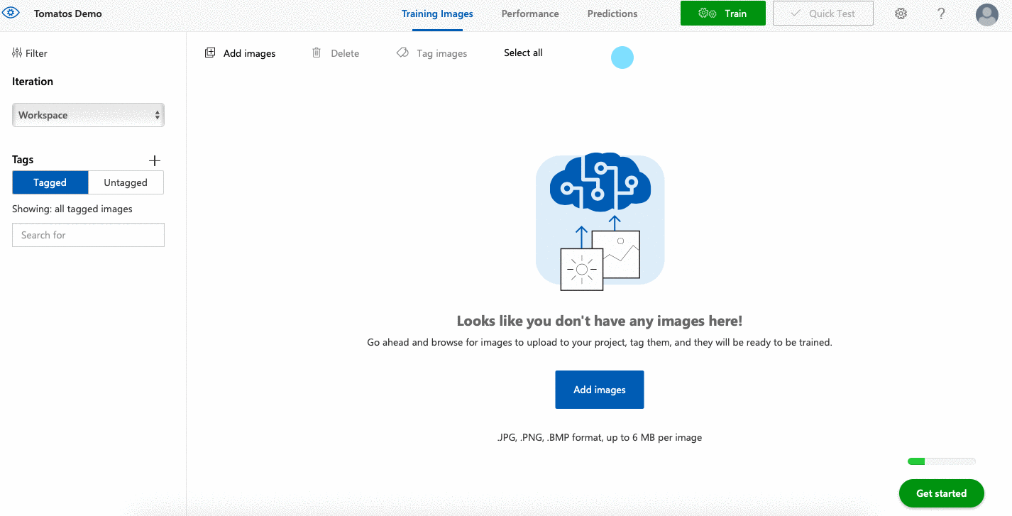

Tag images
In the custom vision project, click on Add images, choose your first folder (with spoiled tomatoes), select all images (that's why we created separate folders) and upload them.
Then create new tag: spoiled tomato and finish the process.
Do the same with the second folder.
Now, you have tagged images in your project.
