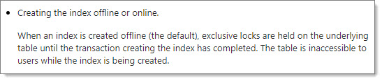

The one concern I expressed about the solution was the potential for the CREATE INDEX process to lock the tables as they were being built.
I did some research, and confirmed my concern that a table will be locked and inaccessible during the CREATE INDEX process.
This is mentioned in the "Performance Considerations" section of this Books On Line page:
https://technet.microsoft.com/en-us/library/ms190197(v=sql.105).aspx
Most Dynamics GP customers use SQL Server Standard Edition, so indexes are created "offline", and the table is locked until the create index operation completes.
SQL Server Enterprise edition does have an "online" indexing option, but from what I have been able to find, even that feature doesn't provide 100% accessibility of the table during the indexing operation, so there may be some challenges in very high volume environments.
If the temporary indexes make sense, my recommendation would be to add the indexes during a maintenance window, such as late at night, and then run the queries the next day (or next few days), and then remove the index when they are no longer needed.
