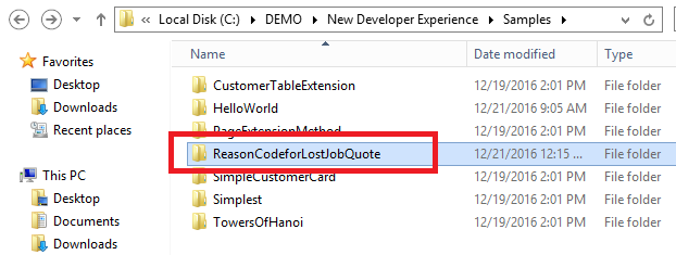

So let’s create a folder for our Project.

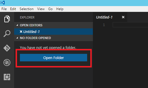

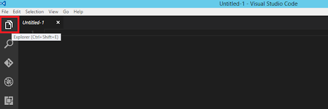

Open Visual Studio Code
Click on Explorer

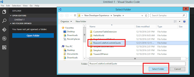

Click on Open Folder
Select the folder which we created above.

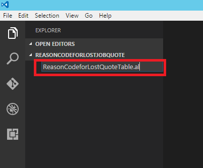

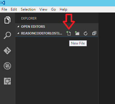

Click on New File as shown in picture to Create .al file

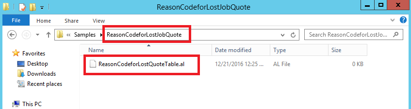

Name the file as ReasonCodeforLostQuoteTable.al

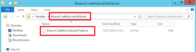

If you go back and check above folder then we can see the created .al file

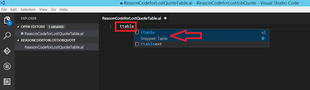

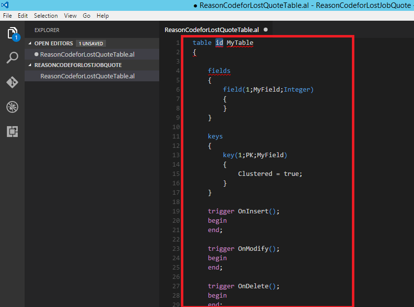

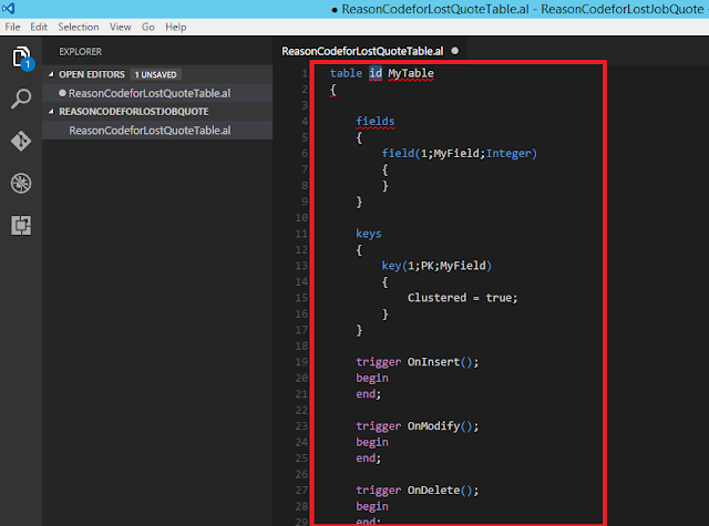

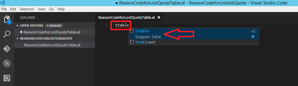

Typing the shortcut ttable will create the basic layout for a table object when using the AL Extension in Visual Studio Code.

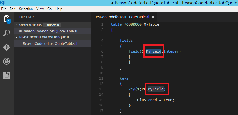

Now it looks like

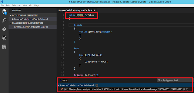

Edit table id
If you try to add any 50000 series then it shows error as shown below

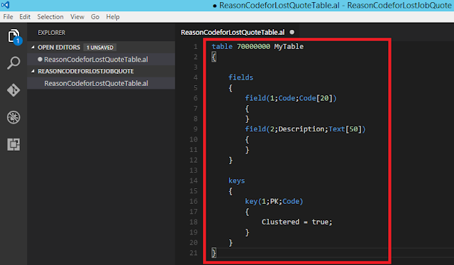

Let’s create table with id 70000000
Edit the Myfield to “Code”
And Datatype of field from Integer to Code[20].
Add field 2 as Description with Text 50.
Now the object looks like this.
