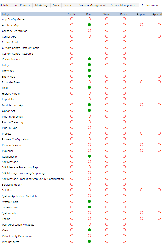

These are the privileges required to load the UI components of the model-driven app and they are all in the Customization tab of the security role form. And make sure the base security role has access to that particular model-driven app.

| prvReadAttributeMap | Attribute Map | Read | Organization |
| prvReadCustomization | Customizations | Read | Organization |
| prvReadEntity | Entity | Read | Organization |
| prvReadEntityKey | Entity Key | Read | Organization |
| prvReadEntityMap | Entity Map | Read | Organization |
| prvReadAttribute | Field | Read | Organization |
| prvReadAppModule | Model-driven App | Read | Organization |
| prvReadOptionSet | Option Set | Read | Organization |
| prvReadRelationship | Relationship | Read | Organization |
| prvReadSavedQueryVisualizations | System Chart | Read | Organization |
| prvReadSystemForm | System Form | Read | Organization |
| prvReadQuery | View | Read | Organization |
| prvReadWebResource | Web Resource | Read | Organization |

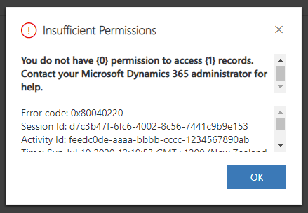

The privileges above might be enough for the model-driven app in the CDS but in Dynamics 365, there are some system scripts which query certain data in the backend. Some of those WebAPI calls will fail silently but some may throw a generic error as below in Unified Interface.
You do not have {0} permission to access {1} records. Contact your Microsoft Dynamics 365 administrator for help.
In that case, open the Developer Tools of the browser and check the descriptive error in the Network tab to find out which privilege is missing. You can read more about deciphering the Unified Interface generic permission errors in this blog post by Alex Shlega.

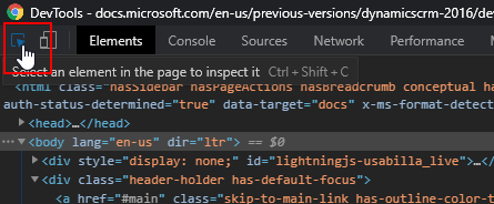

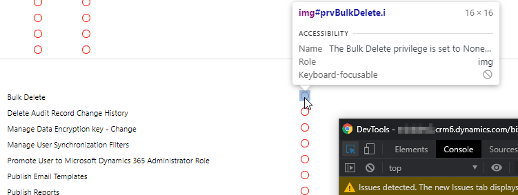

The descriptive error message will say that the user is missing prvActionEntity. If you are not sure where that privilege is located in the security role form, one of the methods is to check this old Dynamics CRM 2016 documentation. I am not sure why "Security role UI to privilege mapping" is no longer included in the Dynamics 365 Customer Engagement (on-premises) documentation or Power Platform documentation. If you see the privilege but not sure if it the prvActionEntity specified by the error message, you can open up the Developer Tools of the browser and inspect the element (Ctrl + Shift + C in Chrome) to see the backend privilege name.

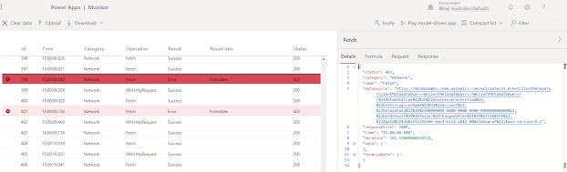

You can also identify those scripts which fail silently due to the missing privileges by checking the error lines in the Network tab of the browser's Developer Tools. Another alternative way is checking the network request details in the recently announced monitor tool for model-driven apps.
