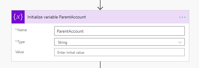

To handle this issue, we are going to declare a variable that hold the Lookup Value (String)

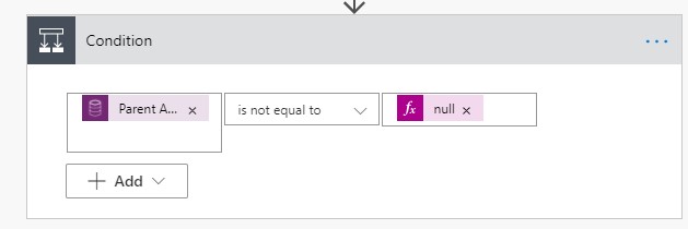

Then we are going to analyze if the source record has Parent Account populated or not

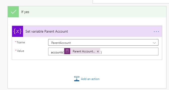

If the Parent Account has Value then we are going to set the variable with accounts(ParentAccount)

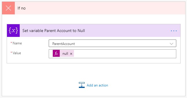

Otherwise we are going to set the value to null
The last thing to do here is to populate the field on your Update
