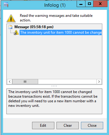

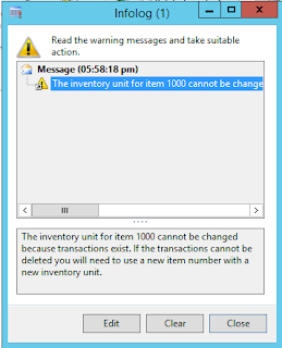

If Transactions Exist, Can The Unit Be Changed?
Sometimes you may not realize that an item was created incorrectly until transactions exist on the item. You will inevitably get this error message when you attempt to make the change: "The inventory unit for item ### cannot be changed because transactions exist. If the transactions cannot be deleted you will need to use a new item number with a new inventory unit."
Infolog the inventory unit for item cannot be changed because transactions exist. If the transactions cannot be deleted you will need to create a new item number with a new inventory unit.
When transactions exist, all may not be completely lost!
This infolog says it all! It can be changed back if the transactions are removed from AX. For example, if it was just added to a purchase order, you can still take it off the PO and change the UOM on the item. If it has been received and invoiced, you are looking at a much more tedious process and might be better off creating the item with a new item number.
