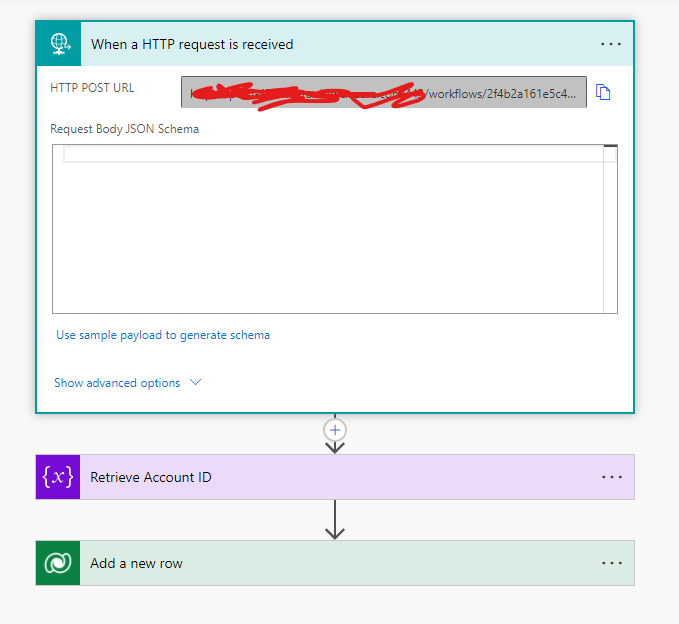

I have created a sample Power Automate Flow for this experimentation
  1. Create a Flow with HTTP Request Action
  2. Once you have saved the flow Copy the URL

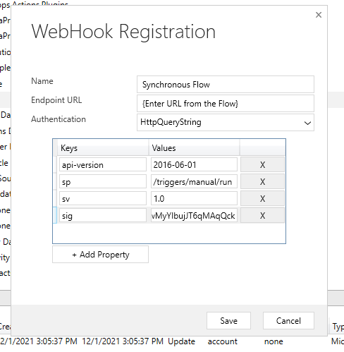

  3. Open Plugin Registration Tool
  4. Register New Web Hook

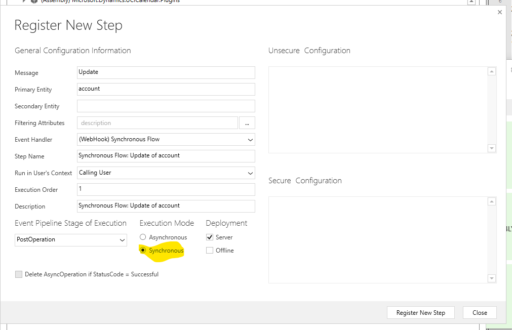

  5. Register a new Step, I want this to execute on update of Account Entity on change of Description fiel
